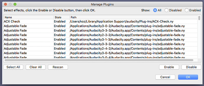

Effect > Plugin Manager.
Do you show ACX Check there?
Or is it complaining it can’t find your show?
Is your show on an External, Network, Internet, or Cloud Drive?
Audacity doesn’t like working on drives other than the internal ones. Close Audacity and move your show to your internal drives (C:\ D:\ ). Then open Audacity.
Hi Koz! Here’s what I see:
Nyquist Plugin Installer Enabled C:\Program Files\Audacity\plug-ins\nyquist-plug-in-installer. in “Effects”. No ACX anything.

I think I see what happened with the appearance of the plugins. I’ve been upgrading my Audacity for billions of years and I think the add-ons just hung around from version to version If you start from dead zero, you won’t have any of these.

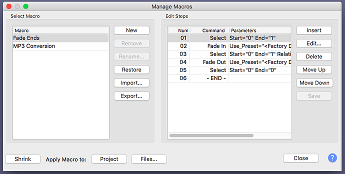

I think I can get the Macro working.

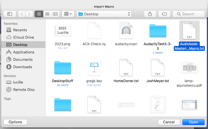

Download the Macro I posted. Save As a text file. I save to my desktop. Yours won’t look exactly like this. You need to convert to Windows.

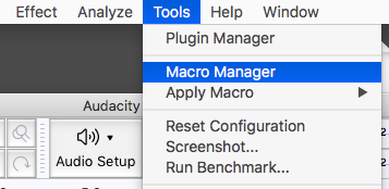

Tools > Macro Manager.
Import
Desktop > Audiobook-Mastering-Macro.txt > open
Open the show > Tools > Apply Macro > Audiobook-Mastering-Macro.
There is no “OK.” It just does it.

I got a response from the other elves how to install a Nyquist plugin.
So that will give you both the Mastering Macro and ACX-Check.
