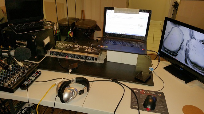

Here is my setup:
Mackie 1202 VLZ4 Mixer
ATR 2100 Microphone

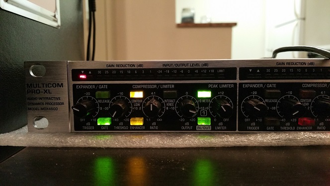

Multicom Pro-XL MDX 4600 Compressor, Limiter, Gate (Both Skype and myself are processed through this prior to being recorded)
2 Windows 8.1 Laptops (One is used strictly for Skype, other for recording)
Audacity Version 2.1.0
Both Laptops are processing the sound through 2 UCA202 USB sound cards. (One for each laptop)
That’s pretty much how I did it.
My variation was to bring the Skype computer connections into the mixer instead of recording them separately. This is the Pando Podcast…

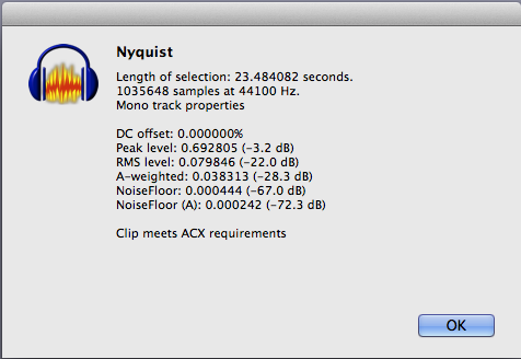

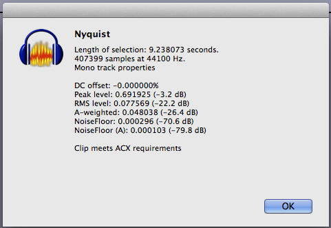

After I cleaned everything up, I announced a simple test recording which passes ACX AudioBook standards with just a slight volume change. No processors, no filters, no effects, no patching. Straight recording. Rock-band microphone into a small mixer and into the computer.

The gate is whacking off the first letter of several words.

ACX had the good form to publish their audiobook sound standards and they’re not insane. They’re about the same sound standards as broadcast. They’re a good, rational goal and we have semi-automated tests for them.

The point of the processor is to slide itself in the middle of a perfect working microphone chain with no effect at all until it’s needed.

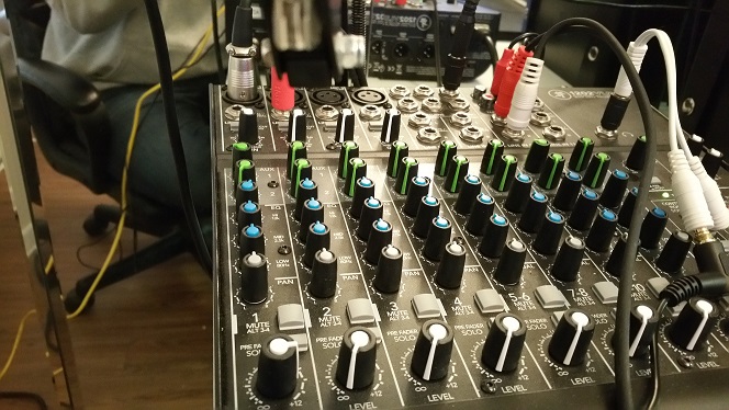

Pump up the mixer until the Audacity sound meters peak/bounce around -6.
Your mixer has about the same controls in about the same locations that mine does.
Gain or Trim about 3 O’Clock
Level around 3 O’Clock
Master around 3 O’Clock (at zero on my mixer slider)
Where are the bouncing Mackie sound meters when you talk?
Where are the bouncing Audacity sound meters when you talk?
If the unbalances are terrific, Audacity overloads and the Mackie is very low, take the Tape Out of the Mackie instead of the Main Out.
Gain or Trim. This is where you set the volume to make the basic mixer strip happy. All the knobs in one vertical stripe. If it’s too low, you can get hiss. If it’s too high you may get the red overload light near the bottom…ummmmm …you don’t have overload lights on this mixer, do you? Attached, this is where mine are.
Level. This is where you balance the microphones against each other. This is where you bring up Guest Number Three a little.
Master. Overall volume. This is where you fade the show out at the end.
All the adjustments are intended to run about 3/4 up. If you find yourself with any controls near either extreme, you have a problem.
You can get rid of P popping with a blast filter. That’s the black tennis racket looking thing just in front of the microphone. Highly recommended.

You might slide the processor back in to help even out volume changes, say when someone decides to get really loud or fade into the sunset in the middle of a sentence. Or not.
Do Not use the gate.

I’m an idiot but I figured out the buzzing problem(s):
I had a cord that was used for sound effects plugged in but not being used. I had the volume at zero (apparently that doesn’t matter), but once I pulled it out, the buzz got much more faint.

Plosives go mostly down. Mount the microphone so the sensitive part is about nose or eye level and point the whole mic down slightly toward your mouth. I don’t have a good picture of this. Most people don’t have this problem. I also don’t remember if you had a mic stand and boom, but it’s more or less required.

I don’t know that the audiobook testing tool will do you any good, but knowing the Contrast trick might be handy.
Drag-select the quiet portion of the clip (attached), and Analyze > Contrast > Foreground > Measure Selection. That’s the noise level. AudioBook standard is -60. Yours is -68 which is quieter (attach-2). You have to press Measure Selection each time you use it. It’s not automatic.
Since you’re going through a mixer, are you sure you need processing for Skype? I did this badly produced clip with just the mixer.
It’s a Really Big Deal that everybody is on headphones so Skype doesn’t have to go through echo cancellation and other processing tricks. She sounds like she’s relaxing on a sofa behind me, doesn’t she? She’s four time zones away. I messed up the Skype microphone setting, so that’s the music problem. I’m going to redo that one of these days.
Same setup you have. I got the music player in the Audacity computer to play music to the mixer and the mixer “show” went to Audacity. My computer has stereo connections for record and play and will cheerfully do both at the same time. So that’s where the Glenn Miller came from.
The other computer was strictly Skype. And yes, it didn’t escape me that the only problem I had during that test was with Skype. !@$%^
