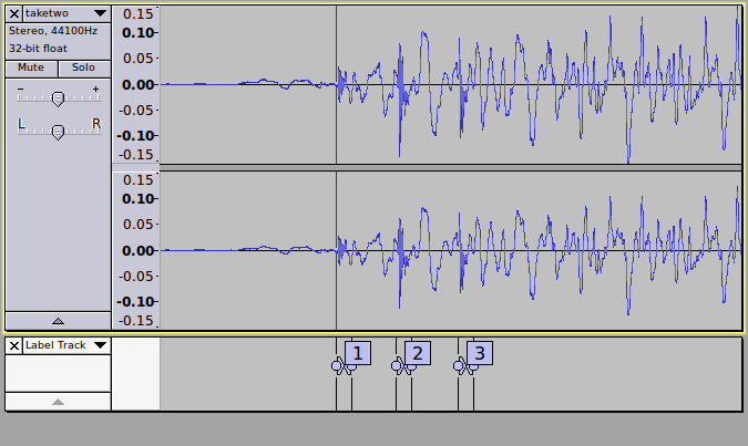

Here we go. Note the clicks at the beginning of each note.
If you look carefully (zoomed in both vertically and horizontally) you can see three little wiggles in the waveform where the plectrum click is.
I don’t know of any way to automatically remove the clicks, but you could delete them then use the “Repair” effect to smooth the edit boundary.
