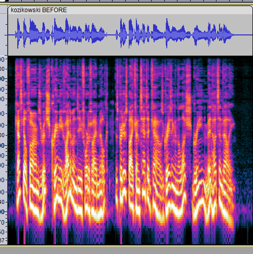

before- after AI
OK, now you need the interp or interpretation of the work. It’s a commercial, right?
The AI did get rid of the last of your fan noise and the room echo.

The AI also heals the notches in the spectrum, (interpolation ?, extrapolation ?) …

before-after AI
