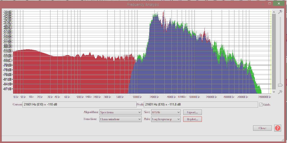

Comparing your example with this YouTube review, you have a big (~10dB) notch at 320Hz
Sound reflections from a nearby surface could be responsible for the notch,
(destructive interference at that particular frequency).
[ BTW TDR PRISM is a free frequency analysis plugin that works in Audacity 3]

Thank you, Trebor. I was able to get TDR Prism installed but could not get it to work on my audio file except for in Preview mode. I do believe I could see the notch in the preview.
Your idea that the notch is caused by a nearby surface is a great tip. I have a wardrobe type surface near the microphone in my closet. Using your advice, I covered it in a thick blanket. The other possible surface is the wall and closed closet door located about 4 feet behind me and the microphone. I’m not sure I can easily cover that. I’m hoping the wardrobe was the problem.

Audacity’s plot spectrum will also enable you to see the notch,
but it won’t allow you to compare one spectrum with another (a reference) in the same window .

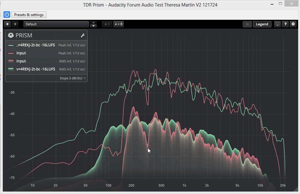

The notch at 320Hz is gone. :slightly_smiling_face:
Occasionally something is ringing at 180Hz (& 1st harmonic 360Hz) triggered by your voice …
It could be the metal pop-shield, or the mic stand.
EQ is good, but could benefit from a 3dB boost from 2kHz to 6kHz …
Green is the generic female voice plot.

Audacity’s “filter curve EQ” is one way …
3db tweak eq
This boost is entirely optional.
You can use Audacity to examine the frequency spectrum of successful audio books read by women, and compare them with yours. [ You don’t need to slavishly copy them, but the comparison will give you an idea of EQs you could try ].
