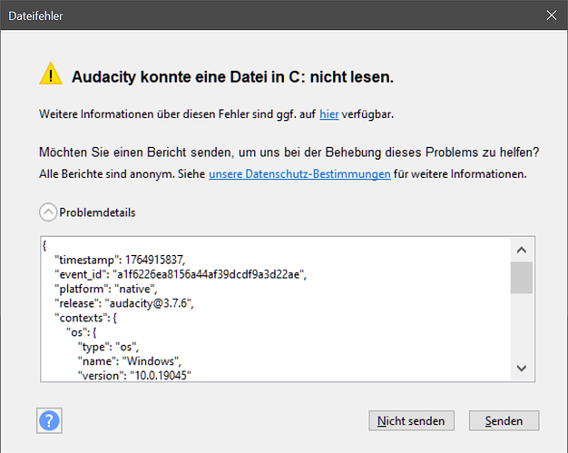

  1. I started a big remix-project by using Audacity v3.7.4 on Windows 10 pro (Version 10.0.19045.3930) and worked MONTHS on that. I saved different versions of the file from time to time, to have a backup and to be able to fetch deleted tracks (old edits) in case i would need them again (which happened a few times).
  2. I just had finished another step of edits and that was file “remix v36”, sized ~10GB (i think 50 tracks or more inside, each up to 9 min. long), which was saved correctly. Like always I wanted to rename it (e.g. from “remix v36 to edit xyz” to “remix v36 edits xyz done”), and clicked twice on the file in Windows Explorer (1st click to mark the file, 2nd click to change the filename). But I did the doubleclick too fast, so that audacity opened the file. Audacity opened the file correctly and I IMMEDIATELY closed the file.
  3. Then I renamed the file and made a copy “remix v37” to go on.
  4. Then I tried to open “remix v37” but audacity came up with the following error:
    {“timestamp”: 1764915837,“event_id”: “a1f6226ea8156a44af39dcdf9a3d22ae”,
    “platform”: “native”,“release”: “audacity@3.7.6”,“contexts”: {
    “os”: {“type”: “os”,“name”: “Windows”,“version”: “10.0.19045”}
    },“exception”: {“values”: [{“type”: “File_Error”,“value”: “Audacity failed to read from a file in .”,
    “mechanism”: {“type”: “runtime_error”,“handled”: false,“data”: {
    “sqlite3.rc”: “101”,“sqlite3.context”: “SqliteSampleBlock::Load::step”
    (audacity wasn´t able to read a file in c:)
  5. I also tried to open “remix v36” but the same error was presented (which is logical because the file was the copy source of “remix v37”).

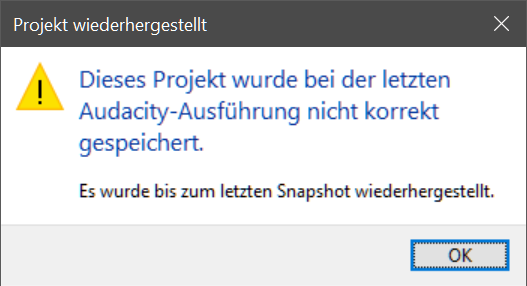

After that I felt mentally strong enough to try the promising python script. If that would fail… but it succeeded, at least at first sight!! There were a couple of lines printed at the screen (I guess the lost sampleblocks), and I didn´t keep the list (cmd-buffer was too small). But the rescue-file was created ok and with the same size as the broken file. Maybe I will do the process again to get the full list as a text-file.
After backing up the rescue-file I opened it in audacity which worked!! Audacity only mentioned the following affair:
(project got recovered to the latest snapshot because it was not correctly saved last time)

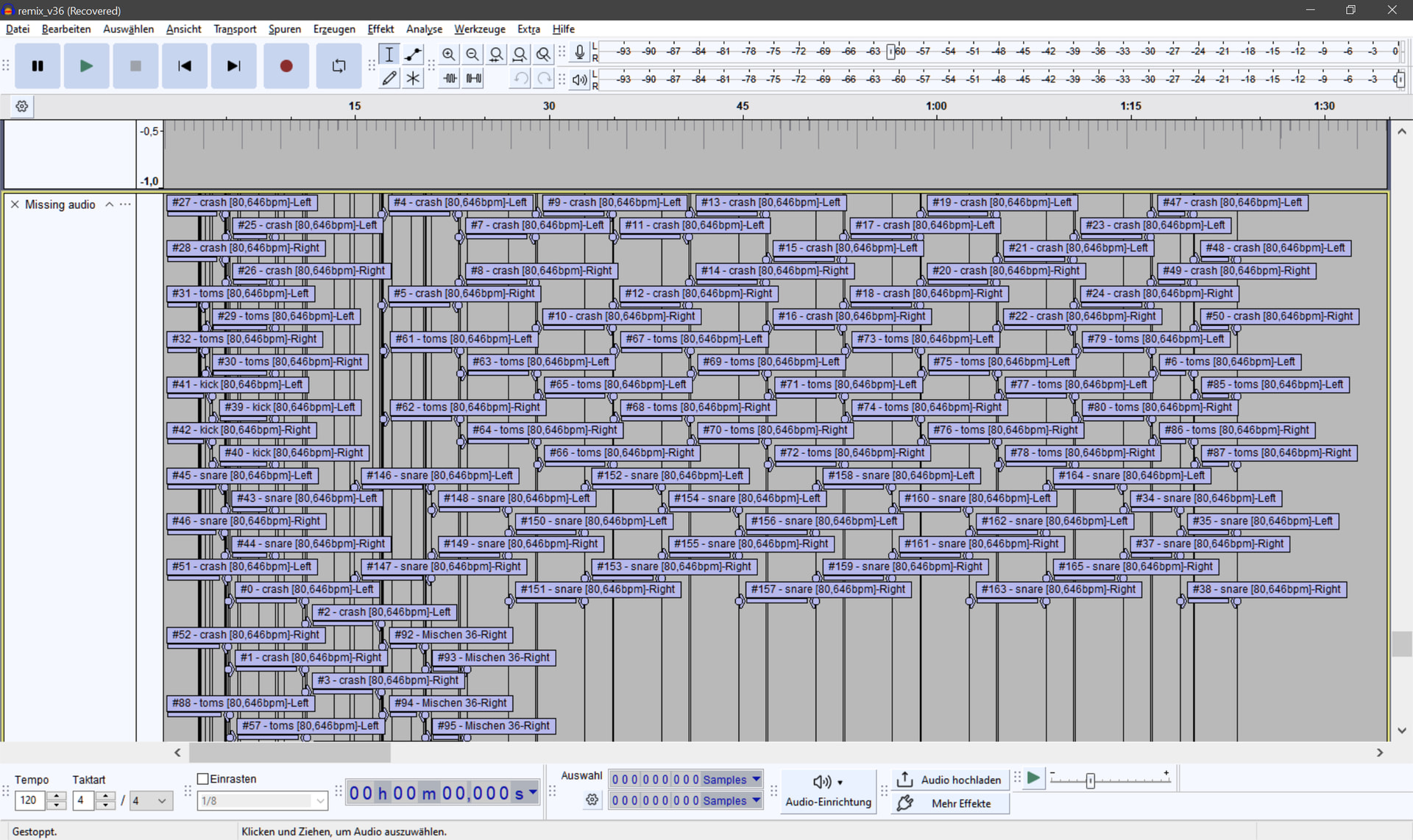

All 188 wavetracks look good (including gain&pan settings)!! A replay of the whole song (97 tracks active, 91 inactive) sounded ok!! At the bottom I found this:
It´s all within the first 1,5 minutes. I guess these are “ghost-blocks” - sampleblocks from “ghost-clips” that never really existed. Those (around 400) blocknumbers that the tool hadn´t extracted.
