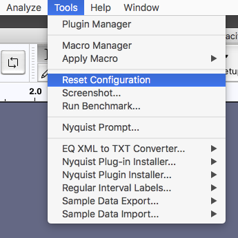

We are informed that Tools > Reset Config does the same thing.

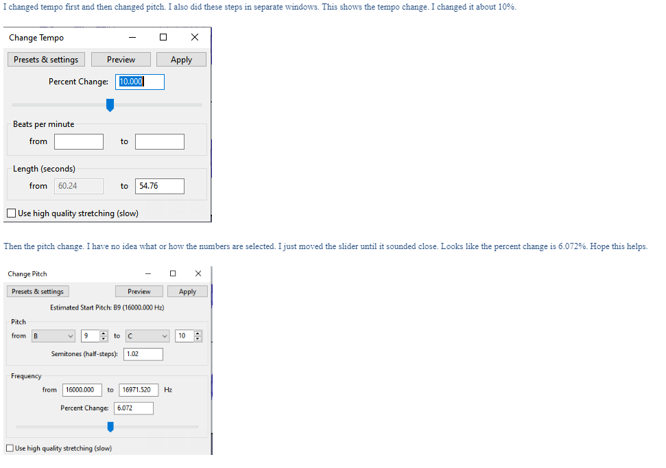

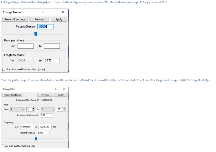

Turns out my podcast partner is having “OK luck” with modifying pitch/tempo to get our voices to sounding like women again for last week’s edited/saved episode using 3.4.2. We are hopeful (but not confirmed yet) that all of the MP3 files she is creating will sound decent enough to release with a disclaimer that we had software issues that distorted our voices to our listeners. I’ll follow up on this thread with the end result. I will also scrub her Windows desktop machine and reinstall 3.4.2 after she is done with last week’s episode as a precaution.

My podcast partner provided the attached information and included screenshots to help.
