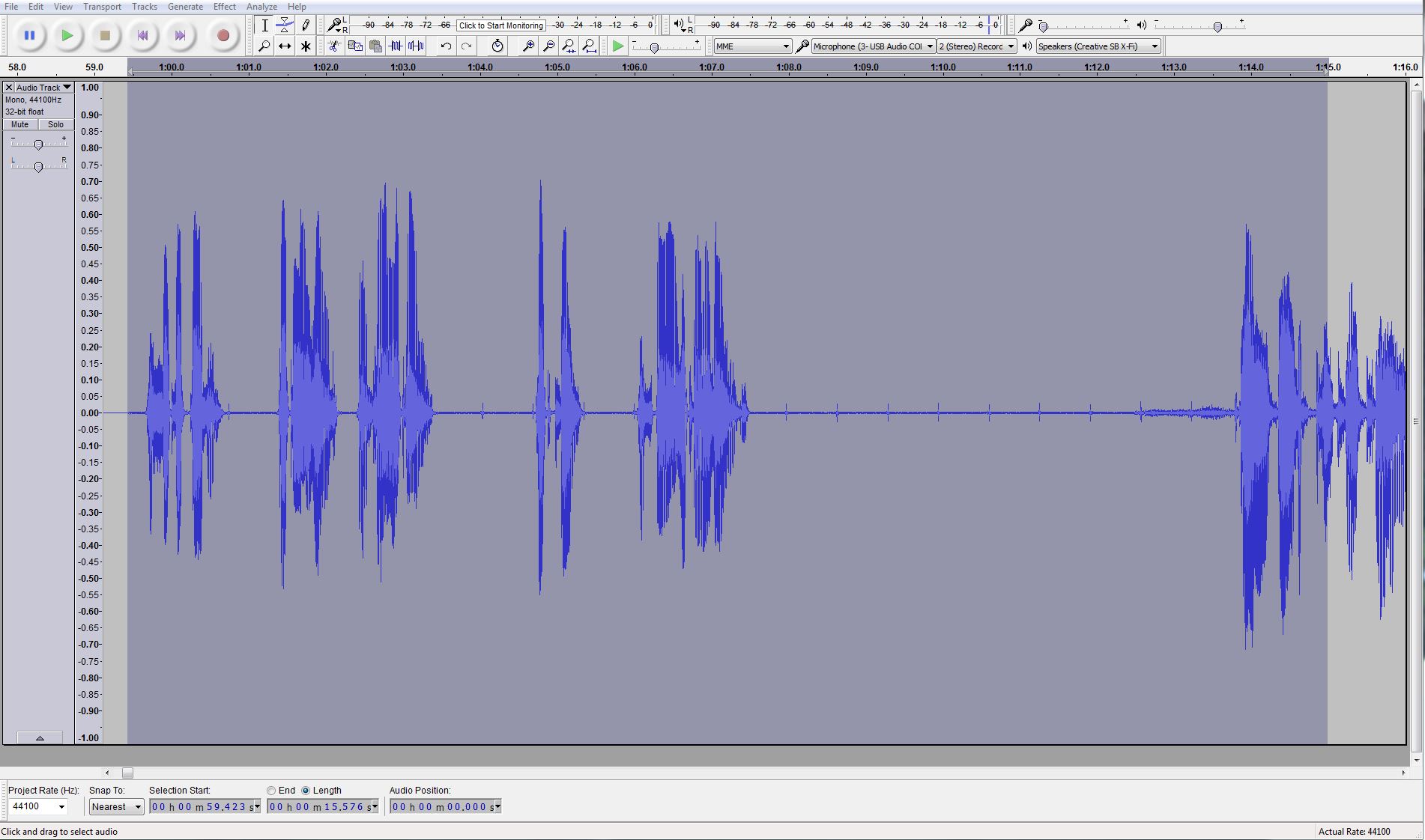

I am transferring some old audio cassettes onto my PC and on several of them, i am getting a periodic “click”. I am using an ION Tape2PC USB Cassette archiver connected to my PC. It doesn’t happen with every cassette and sometimes only on one side of the cassette i’m transferring so i don’t believe that it’s a hardware issue.

I’ve been trying to read through the FAQ and the forums and most solutions appear to work on repair single clicks rather than periodic ones like in the recording. Apologies in advance if i’ve missed the obvious solution somewhere :smiley: . I’ve tried using a notch filter, de-clicker and pop-mute but don’t appear to be able to get a good result without decimating the spoken word.
Is there a simple method in Audacity for removing this kind of issue.

It sounds to me like a noisy transport mechanism on the tape recorder or the tape is moving around too much inside the cassette. You could try tightening the tape. Not an Audacity issue.

Audacity Click Removal does almost nothing with those clicks. I would still argue it would be better to try to fix the problem with the tapes/tape recorder. Ion might help you.
Using your WAV I had success with the Noise Gate Nyquist plugin.
It does make the space between the words sound artificially quiet. You could always Generate > Noise… at very low amplitude into a new track which will then be mixed in.
See here for how to install Nyquist plugins: http://wiki.audacityteam.org/wiki/Download_Nyquist_Plug-ins#install.

Did you use Audacity’s 2.1.0 Noise Reduction? I hear some leftover bird-song artifacts in the pause. You may want to vary the settings a bit, raising sensitivity a little until you don’t get that effect. Try some increased Frequency Smoothing too, from 3 to 6, which should leave that inhalation sounding more natural.
Do what Gale says to get rid of thumps, but for amusement I saw whether my Declicker could be decent for this unintended purpose. They are not gone but much less evident with settings:
sensitivity 3,
step size 5,
max length 5,
low frequency 37.5,
otherwise as defaults. Maybe better could be found with experimentation.
