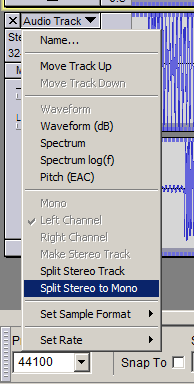

Select “Split stereo to mono” to convert your stereo track into two mono ones …
then delete the unwanted mono track by clicking on the “X” on the top left of that track.
  1. Split the Stereo track (in 1.3 you can “split stereo to mono”)
  2. selete the unwanted one
  3. use Tracks > Add New > Audio Track
  4. Copy the first track into your paste buffer - select it and use CTRL+C
  5. select the empty second track and past the audio in
  6. Join the two mono channels into a stero track
The split and join commands are all accessed from the little-sownward-pointing-black-triangle thingy at the top right of the track control box.

That works, but is unnecessarily complicated.
In Audacity 1.3.12 al you need to do is (as desribed by Trebor):
  1. Split to mono
  2. Delete the unwanted track. The remaining (mono) track will play equally from both speakers.
    Other options:
In Audacity 1.2.6:
  1. Split Stereo Track (there is no “split to mono” option).
  2. Set the track that you want to keep (using the track drop down menu) to mono.
  3. Delete the other track.
In either version of Audacity, if you specifically want a 2 channel (stereo) track (you would not normally need to do this unless you are wanting to apply stereo effects such as reverb to the track):
  1. Make a mono track as above,
  2. then duplicate the track (Ctrl+D)
  3. From the drop down menu of the upper track select “Make Stereo Track”
