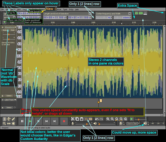

Optimized Layout + Total Lenght, More for the Waves
This Layout is optimized [to have all [or most] bars using as less rows as posible] for either a 4:3 monitor, or eg for having Audacity alongside other program in a 16:9 monitor.
In addition to re-arrangment of bars, this also shows what i said in ‘Provide start, end, and length of selection’ Provide start, end, and length of selection :
That exist already: (“Audio position” = ‘Start of Selection’), and chose: “Lenght and end of Selection” option.
So, since “Audio position” serves double duty (as Audio position and as Start of Selection), please don’t take it out. Putting it in its own ‘longer’ bar could waste more space than now.
What i can see cold be done is take out the labels ‘Project rate (Hz)’ and ‘Snap-To’ and make them appear on hover, this way their actual values can be stacked one on top of the other and so shorten the bar.’
'The label “Audio position” can be also eliminated [it would also appear on hover*], and in its place put the Total Lenght of the song/whatever, which is already a request [+1 there].
[since “Audio position” serves double duty (as Audio position and as Start of Selection), the 2 1st options “Start and Lenght of Selection” and “Start and End of Selection” could be eliminated.]
*on hover it would show: “Audio position/Start of Selection”
Even more space for Wave/s could be gotten with ‘Stereo 2 channels in one pane via colors’ Stereo 2 channels in one pane via colors
which would look better if the user chooses colors as with Edgar’s customized Audacity , see ‘Easier to see selections’ Easier to see selections

The optimized Layout i put is in only 1024x768 pixels, has all [except 1] toolbars, if all same bars, it uses 1 less row vs the usual/shipped Audacity layout.
Implementing user chooseable colors for ‘Stereo 2 channels in one pane via colors’ would add even more to the already extra preferences to manipulate in a like-Edgar’s Audacity; even so, I agree with his philosophy of ‘power to the user’'; extra options can be put in ‘advanced’ sections in Settings.
