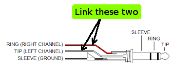

If you are able to solder and can make up an adaptor lead, then you could make a stereo to mono headphone adaptor. What you will need is:
1 x Stereo Jack plug (to plug into the umc202)
1 x Stereo Jack socket (to plug your headphones into)
A short length of headphone (or microphone) cable.
The easiest way to do this is if you can find a stereo jack to stereo socket adaptor lead which has either a plug or socket that can be taken apart. You would then just need to short out the “tip” to the “ring” in either the plug or the socket.
