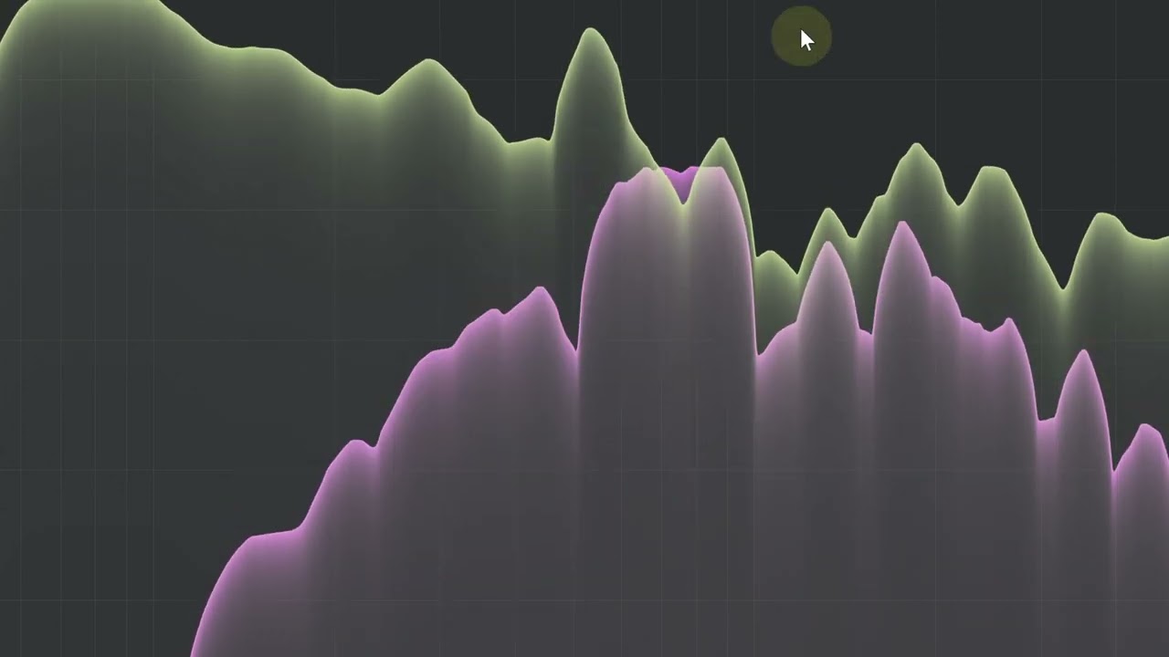

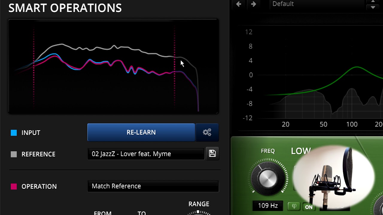

There are EQ-matching plugin$ which automatically make one mic sound like another…

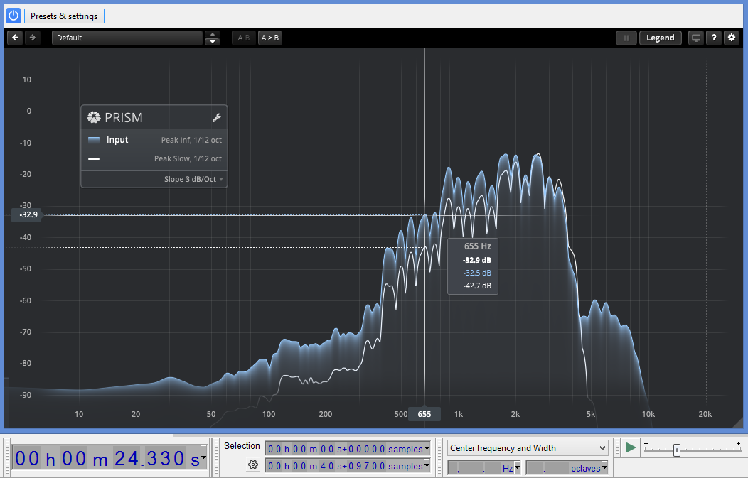

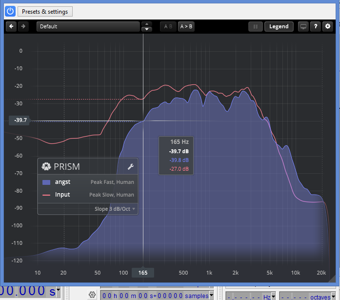

TDR have a free plugin called “prism” where you can load in an audio file as reference EQ, but you have to manually adjust the audio playing to match it with a real-time equalizer.

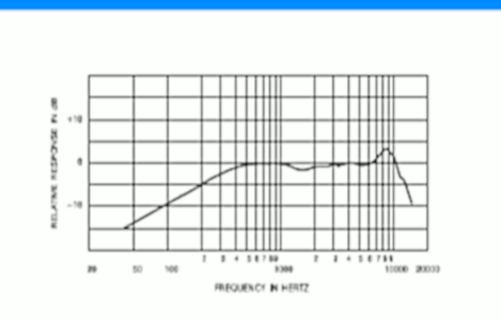

If the Shure® data sheets are to be believed,
the SM11 has a 4db boost between 7-10kHz that needs to be cut to match the SM7B
11-vs-7b

Hi again, @Trebor. Guess I’m not as up on the plug-in/EQ process as I thought I was. I essentially just took the two spec data sheet EQ curves from Shure that you included for the SM11 and SM7B respectively, and I manually adjusted the SM11’s curve to match the SM7B’s as best I could, cutting the SM11’s 4db boost between 7-10kHz as you pointed out. Q: Was this what you were referring to when you said that one could match the mics manually?

Also, wondering if the demo version of Nova GE allows for the precise mic-matching demonstrated in the first video you referenced. Or does only the paid version offer this feature?

Tokyo Dawn’s free PRISM plugin will draw a spectrum plot of any audio file you load into it. If you do two* of those: the 2 different mics recording the same person/location/script, then load them both into PRISM you can measure the (manual) corrections that need to be made so they match, e.g. using Audacity’s equalizer.
