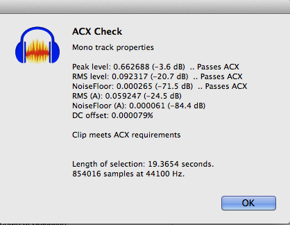

The file passes but, there have v\been times when I can get the file to pass just using Eq(low roll off), RM normalize and limiter. That worked this aft but tonight I have to use a much longer chain to get it to pass the ACX check.

This is Cecilla Ping with Audiobok Mastering and two versions of noise reduction. You smack your lips at the half-second mark and that smack bleeds through the reduction. Otherwise, I think it sounds reasonable and it easily passes ACX Check.

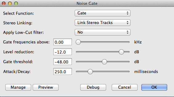

I did the mastering manually and added two noise reduction steps, Reduction and Gate.
Does that sound OK to you? I’ll detail how I did it.

Effect > Noise Gate.
That’s it.
