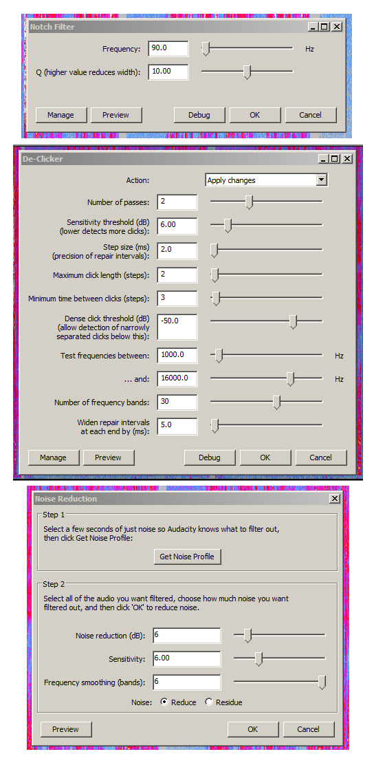

There is a VERY loud tone at 90Hz . That can be quickly removed with a notch filter …
The latest version of Audacity has a notch-filter in the effects list . If your version of Audacity doesn’t you can get one here.
De-clicking is a far more time-consuming and computationally-intensive task than removing constant hum with a simple notch-filter.
I used the [beta?] Paul-L de-click plugin in Audacity , which you can get here … Updated De-Clicker and new De-esser for speech
However that plugin can easily take 5x the playback-time to declick audio. I’ve only used the Paul-L de-click plugin on very a few minutes of audio in one go , others have complained a crash occurred when they tried to process hours of audio in one go.

The Paul-L De-Clicker plugin* does do a good job , but takes its time. With the settings shown below the processing time is approximately three times the play back time …
[ * Audacity does not come with Paul-L’s deClicker installed , you can get a copy of it from here : the “Declicker.ny” file at the bottom of the post . Put a copy of that “Declicker.ny” file into Audacity’s plugins folder , then it can be included in Audacity’s “Effect” list via “manage” at the top of the effect list ].

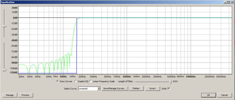

Your [female] voice doesn’t contain frequencies below 150Hz , so using the equalizer you could remove all content below 150Hz , which will remove the deep parts of the humm noise …
In addition you’d have to apply a notch-filter to remove the 158Hz tone.
