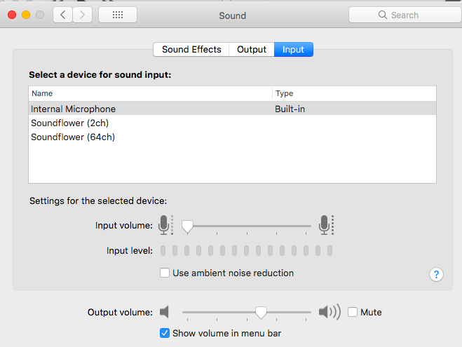

Since you’re on a Mac, you should know that the Mac has tools and corrections. Apple (upper left > System Preferences > Sound > Input.
The built-in Microphone has Ambient Noise Reduction.
I’ve never used noise reduction, but I do know that if you’re careful, you can do some fine sound recording. The older Macbook Air has two microphones and can do directional recording.
