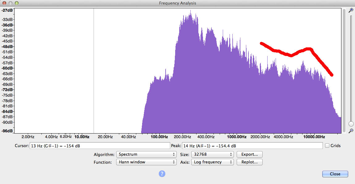

Don’t bet the farm on that. There is no known cure for an essy microphone either before or after narration. I would give anything to be able to tell people which towel to throw over the microphone to stop it from doing that.
Essing has very clear symptoms in the Audacity measuring tools, but none of that measuring and testing has resulted in a way to get rid of it.
Read this illustration as increasing pitch left (thunder and earthquakes) to right (air-leaking-hiss and tinkly bells). Louder is up.
That lump on the right is artificial. Your normal voice doesn’t do that. I know you’re saying to yourself now, “Well, just get rid of it.” It didn’t work. If you use the normal sound tools to make that go away, your voice turns into talking-under-a-blanket mud. There has to be voice content analysis algorithms and that makes my head hurt.
