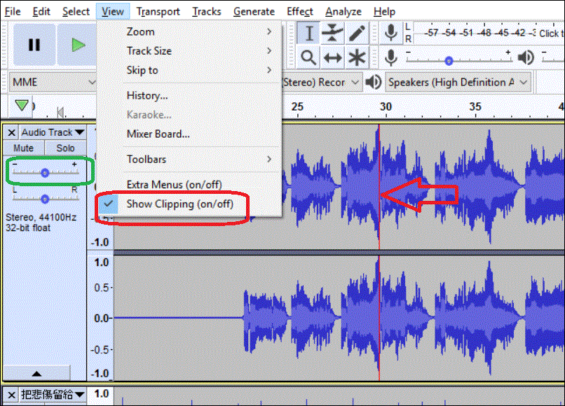

Thanks for the information and suggestions. The View → Show Clipping is useful.
One of my records (screenshot below) doesn’t show any clipping on top or bottom. But View → Show Clipping shows me those “hidden” clippings located in the area marked by the vertical red line.
It’s good idea to turn mic level lower when record, and then use the volume of that recorded track (green circle in screenshot below) to adjust sound level before export it to a file. Do I understand right?

There is a program called Clip Fix that tries to repair a single momentary overload (red) point, but it’s really just guessing at it. It puts in the clean musical note it thinks might have been there based on notes before and after.
Overload (clipping) is a point where the digital system stopped following the music. There is no accurate note to rescue or repair. The overload point is called “clipping” because it looks like someone came by and clipped off the top or bottom of the blue wave.
Audacity > Effect > Clip Fix
Much better to record at a slightly lower volume and not have overload at all.
Don’t record too low, either. It’s possible to record volume so low that the natural noise in the system starts competing with your performance. Sometimes audiobook readers get that by accident.

I think that English came out wrong. You avoid the damage if you reduce the volume of the performance. After you create the damage, it’s permanent.
There’s an oddity with Show Clipping. You can’t actually have a tool which measures that. Because there is no sound over 100%, you can’t measure the sound that went over 100%. The best we can do is run in the subjunctive, if you remember your English lessons. The sound would have gone over 100% if it could.
There was a serious discussion how to design that tool. It’s not as easy as you think.
