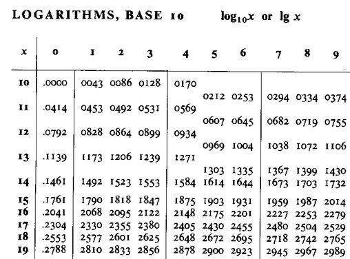

Did you try the plugin? Again, I can’t emphasize this enough, your message has to be right-brain impressionistic and simple. Not memorizing log tables.
