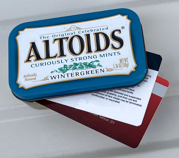

Meanwhile in California, It turns out that an ordinary metal Altoids container makes a terrific Faraday Cage for your proximity-firing credit cards.
Make a note of it.
