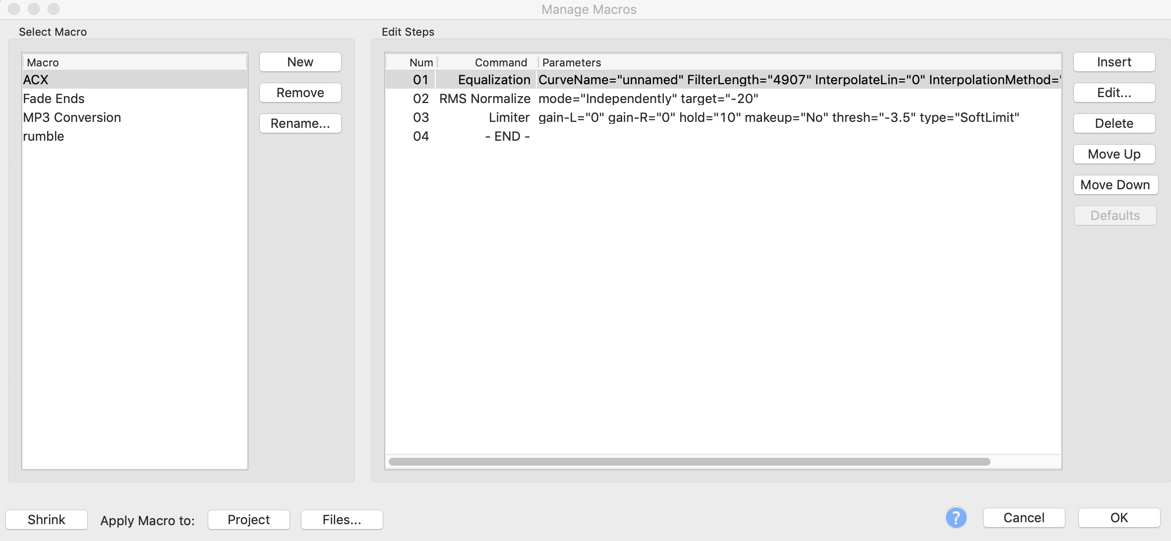

As for the Macro- I created it myself, using the steps outlined on here-- Without putting all the specific settings in, I pulled it from Missing features - Audacity Support
I just input it into a macro myself. Does it matter if I do them one at a time, vs the macro running each process one at a time? I’m confused.

Macro.
The first step in the Macro, Equalization, doesn’t always follow you when you apply it to the work, and it’s not always obvious when it fails. This is an actual Audacity failing and will be addressed in the next release.

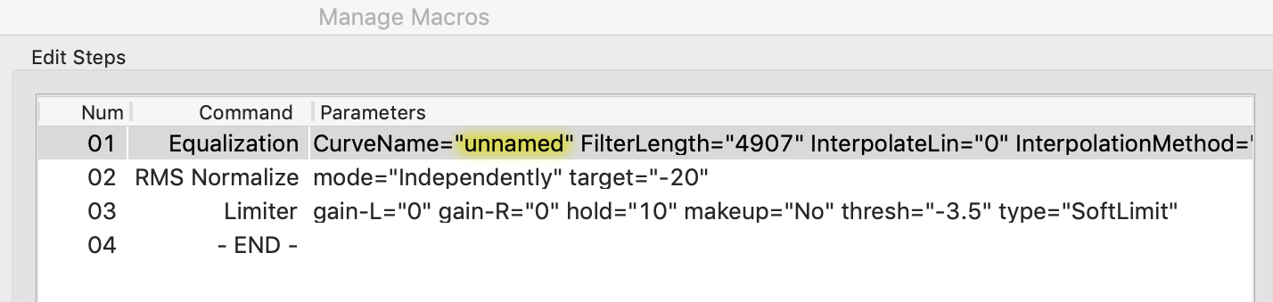

If you don’t specify (name) the equalization curve, the macro will apply whatever the last equalization curve used was,
which may not be the one you want. For consistency create a preset curve and use its name in the macro.
