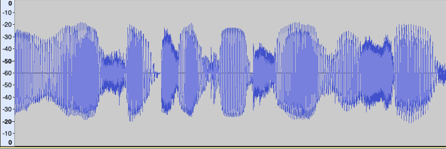

I don’t know what a non-symmetrical voice is lol- I’m guessing I have one, is it because I have a lot of variation between loud and soft?
See the blue waves have an up and down middle at Zero (on the left). Some voices have uppy waves that don’t match the downy waves. They’re non-symmetrical. That has to do with mouth construction, sinus size, breath control, etc. etc. Some performers are convinced the world will end because of this effect. Probably not. I’ve never seen the tools get confused by that.
Still confused by this…don’t my uppy waves match my downy waves? (are those the technical terms lol). I’m not concerned about it, I’m just trying to understand

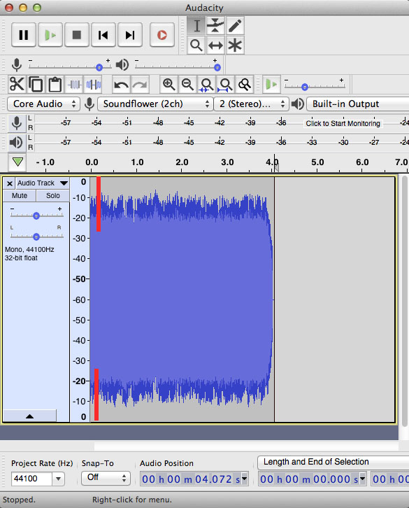

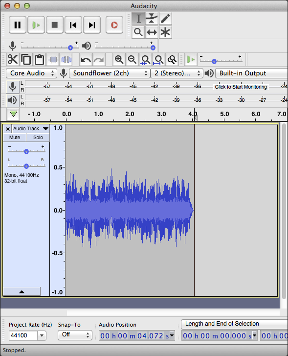

Surprise. You picked another display variation. You selected Waveform (dB) with the drop-down menu to the left of the blue waves. Audacity defaults to Waveform, which is percent rather than dB.
Like this:
0 percent in the middle (dead silence), 50% half-way up and 100% all the way up.
This is why in some difficult problems we recommend you post a screen capture or grab of your work. So we’re both singing from the same hymnal.
Both waves tell you stuff, but in Waveform (dB), the critical area of the waves is in the top 1/16 inch of the screen. Rough to see well.
In Waveform, it’s easy to see when your blue wave tips just occasionally touch 50%. like in the above picture.
Yes it was an awkward choice to have the bouncing sound meter and the blue waves measure the same thing but look different. That’s a discussion for the developers.

I’m still not sure why my voice doesn’t look asymmetrical in Waveform DB but does in Waveform. Thats confusing. The only reason I use Waveform DB is because some tutorial I must have seen a month ago told me to do it. And I can see what I’m doing better. I can’t see what I’m doing at all in Waveform, no matter how far I zoom in?

That’s why it can be misleading to use Waveform (dB), You can be way off volume and still think you’re doing fine because of the mass of blue in front of you. Most of that blue can’t be heard, only the loudest about 24dB. That’s why the Audacity default waves are not dB.

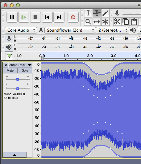

There’s the Envelope Tool (two vertical black arrows and bent line). That lets you draw volume corrections right on the screen.
I went nuts with control points to show you it was possible to get a very graceful and gradual change. You can put the control points anywhere you wish. Drag a control point off the screen to get rid of it. Don’t forget to go back to the “I-Beam Tool” when you’re done.
Yes, sudden Blackness Of Space changes in background volume are not welcome.

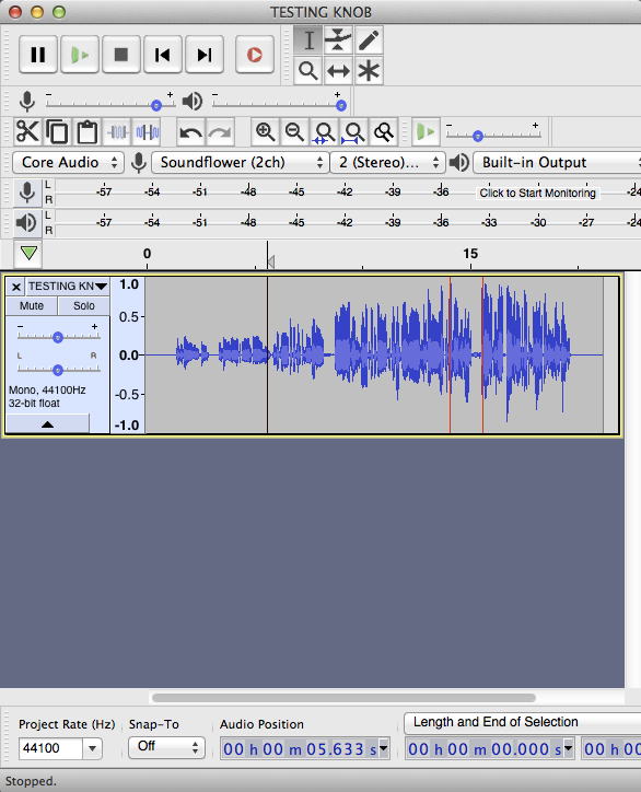

I have recorded a test, it appears when the “gain” knob is turned to about 2:00 I get a nice even green light the whole time. That’s what I thought I was shooting for- when I’m about 4:30 or so is when it seems to be mostly yellow and green. Then about 5:30 ish is where its mostly red. I think I just recorded everything at too low of a volume! I couldn’t find any information on what level I should have the gain turned to, and it seemed like having it stay mostly green was the goal, so I just turned it to where it stayed green the whole time (or MOST of the time) I was narrating.
And I totally see what you mean about the asymmetrical sound waves. That’s interesting. Seems to be because I have a lower pitched voice, but still have some brighter tones to it.
And there’s no good way to know until you produce that test sound clip. There’s a very good chance that high volume sound damage may happen in the interface at a lower volume than it does in Audacity. It would be super good to know that.

All the critical parts of the wave are crammed into the red zones, which we all know is for immediate loading and unloading of passengers only.
The red areas are trying to display overload (clipping), peak recording volume, -3dB Peak ACX and the ACX RMS loudness range. All those important values are smashed into the tiny red areas in Waveform (dB).
It gets worse. If you’re doing this as a way to see your noise volume down in the -60 range, that may still not be very useful without extending the graphic quieter than -60dB which will make the red areas even smaller.
I know people who use Waveform dB for everything, but their work is existing recordings which are a lot better behaved than live speech.

The interface does perfectly expected things. The borderline between green-ish and yellow corresponds to our recommendation for normal recording volume—tips of peaks roughly around 50%. Heavy yellow is OK, but you are spittin’ distance of possible sound distortion. Any theatrical emphasis during that passage and you’re dead.
Make sure Audacity View > Show Clipping is turned on. Note in my attachment the thin red lines at the “Red Light” announcement. That is distortion where the digital system stopped following your voice because it was too loud. If you do enough of that, the damage is harsh, obnoxious and permanent.
So you can keep one eye on the interface and pretty much see how you’re doing. Also, very highly recommended is listen to yourself on the interface headphones connection. People’s voices tend to even out when they can hear themselves in real time as they perform.
Oh, the instructions? They suggest a lot more damage than actually occurs, no doubt to keep New Users out of trouble. In fact, the interface works exactly correctly and I have no trouble recommending it. This was an insanely valuable exercise. Thanks!
GOOD! I will turn the knob up a bit the next time I record, obviously not for this book since I’m done recording. I have “show clipping” turned on, but since I had the gain set so low it has never spiked red until this particular exercise.
So just to be sure I understand- where I had the knob turned at about 10 seconds (about 4:00 on my dial) would be the recommended setting- Mostly green with just spikes into yellow- and no red.
