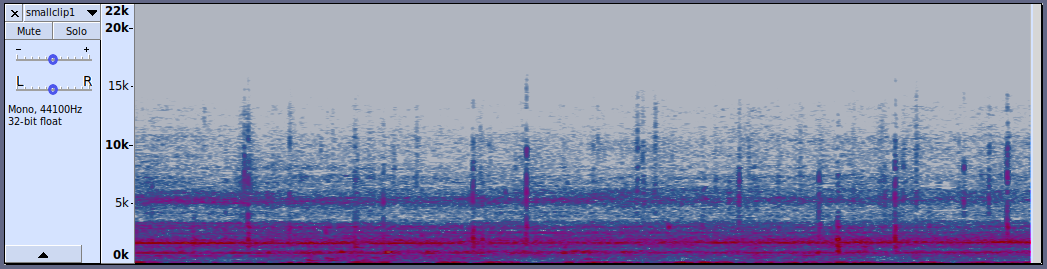

All I’m really certain is that snapping shrimp snap at frequencies of about 2 kHz - 300 kHz so I’ve just used the high pass filter to filter out any sound below 2 kHz. I’ve attached a screenshot of what I managed to scrape together for my first sample and the second sample (which is much longer and contains magnitudes more clicks).
@Steve: Sorry I forgot to answer the question, but yes, I would be counting/quantifying each red vertical line.
Your microphone / hydrophone appears to have a frequency response up to about 16 kHz. (You can adjust the vertical scale to see this region: https://manual.audacityteam.org/man/spectrogram_view.html#zoom)
Below about 5 kHz, there’s a lot of other sound, making it difficult to pick out the “snaps”. So we need to concentrate on the frequency band 5 to 16 kHz.

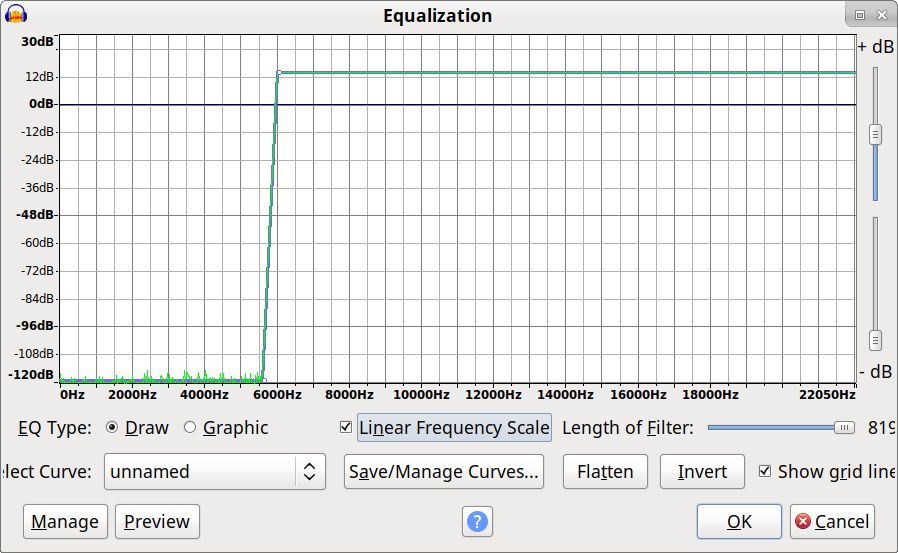

I’d suggest mixing the track down to mono, so that audio in both channels gets treated the same (“Tracks menu > Mix > Mix Stereo down to Mono”)

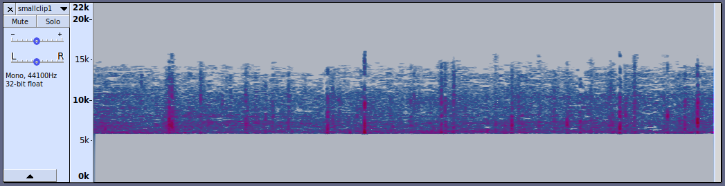

Here’s the track again after applying a very steep high-pass filter using the “Equalization” effect at around 6 kHz, with about 14 dB gain in the pass-band:
And now, amplified with the “Amplify” effect (default settings) in normal “Waveform” view:
