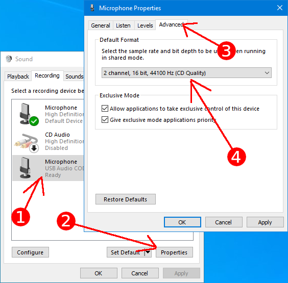

Right click the Windows Speaker icon > Recording devices. Find the right one. I don’t know any handy spells other than it’s going to mount as USB Audio CODEC.
Select it > Properties > Advanced: Default Format Dropdown: 2-Channel, 6-bit, 44100. > Apply > OK.

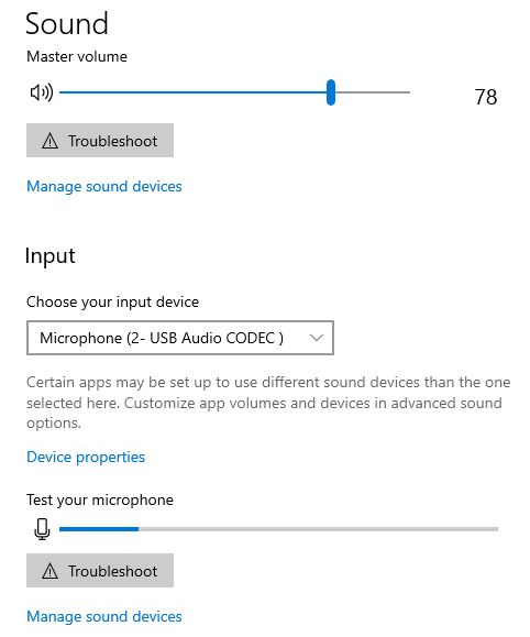

After doing this - I get a meter reading on the Windows Sound Control Panel for testing the mic when I strum guitar, and I get no reading from talking, and it’s the USB mic selected so I know it is not the laptop mic. This means I am getting a signal from the USB cable connected to the UM2 when I stream the guitar.

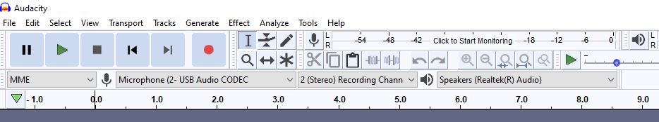

Check that you have the USB device selected as the recording input in the Device Toolbar.
I do have it selected.

OK see two screenshots of the meters working from Windows Control Panel for Sound on the “Microphone (2 - USB Audio CODEC)”.
One screenshot from Audacity for devices selected.
And a text file with the Audacity Audio Devices info you asked for.

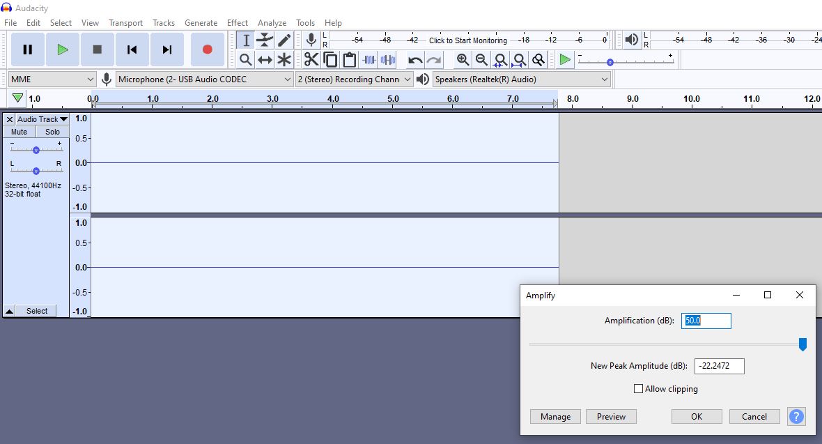

Let’s check that it is “dead silence” rather than “very very low level”.
  1. Make a test recording.
  2. Apply the “Amplify” effect with default settings (make a note of what those settings are and include that info in your reply).
  3. What happens?

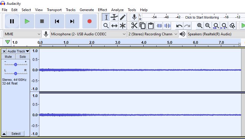

OK two screenshots. One of the original recording while strumming the guitar and showing the amplify affect settings about to be applies. The other with the amplify affect applied. It just sounds like scratchy noise.

I made this screenshot - I see that you don’t need it, but it may be useful for anyone reading this later:
Probably better to select “2 channels, 16 bit, 44100 (CD Quality)”, since you probably want a standard audio file at the end (and 44100 is the Audacity default).
