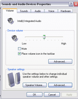

Click on the “Start” button and find the “Control Panel” icon - open up the Windows Control Panel.
The Windows Control Panel has 2 different interfaces -
If you are using the “Category View”, click on “Sounds Speech and Audio Devices”, then on “Sounds and Audio Devices”.
If you are using the “Classic View”, double click on “Sounds and Audio Devices”.
It should look something like this:
You will see that there are several “tabs” on the “Sounds and Audio Devices” Properties Window. On the First tab (as shown in the picture above, make sure that the “Place Volume in Takskbar” has a tick - if not, select it now and click “Apply”.
If you click on the “Advanced” button, it will open up the “Windows Mixer” - you can also open this from the yellow loudspeaker icon on the taskbar at the lower right corner of your desktop near the clock. We will want to use the Windows Mixer later.

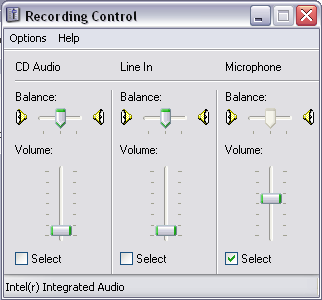

Hopefully this is all working. Now, if you connect an ordinary microphone into the microphone input socket of your computer, you should be able to record and play in Audacity. If you cannot record, then you need to select the “Mic” input for recording in the “Windows Mixer” (loudspeaker icon). Note that the Record settings in the Windows Mixer are on a different part of the Mixer to the playback controls that we saw before.
To open the Record settings on the Windows mixer:
  1. double click on the loudspeaker icon (or Right click and select "Open Volume Control)
  2. Click on “Options”
  3. Click on “Properties”
  4. Select “Recording” and click “OK”
    You should now see something like this:
    You will see here that the Microphone input is selected. I can adjust the recording level with the microphone recording level slider.
If you cannot see the microphone input, or if you are using the “Line in” and you cannot see the “Line input” control, or if you are recording from “Stereo Mix” and you cannot see the “Mix” recording control, then, in the Windows Mixer:
  1. Click on “Options”
  2. Click on “Properties”.
    All available recording inputs are shown and the inputs that are selected here will be displayed in the mixer window.
