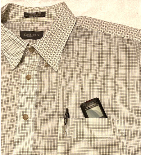

All my regular recorders can work directly in WAV to avoid this trap. This is my Olympus which will hide in a shirt pocket.
It will accept a special microphone to record both sides of a phone call.
