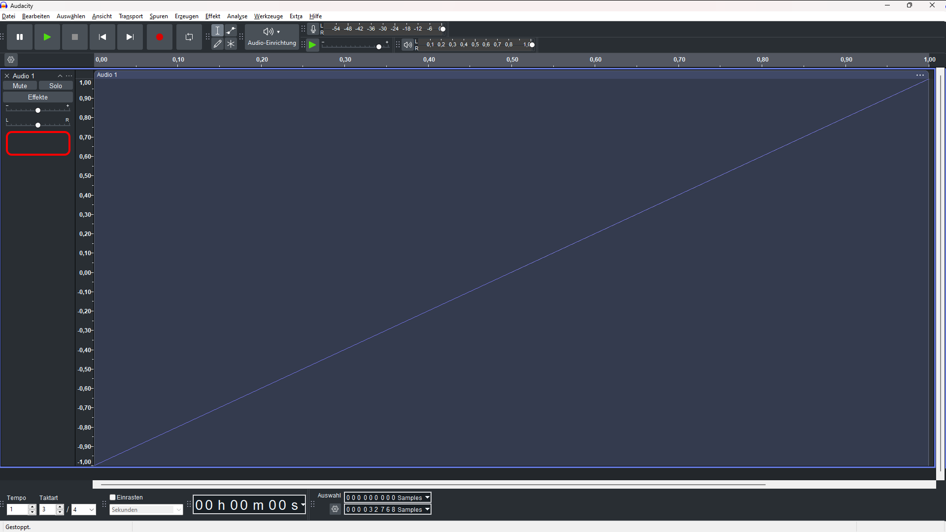

It has come to my attention, that in a recent Audacity version (not sure, which one, since I can’t see it anywhere) the design of the tracks seem to have an overhaul. However they seem to lack their information about their sample rate and bit depth. I made a red outline for clarity:
As far, as I know, there used to be the info on every track, there.
I can’t seem to find setting, to turn the info back on, either.
I wanted to know, if anyone else is experiencing that.
If this isn’t a bug, I can’t really see, why one would remove vital information, like that.

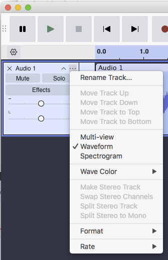

In Audacity 3.6x, select the three dots to the left of the track
Format.
Rate.
