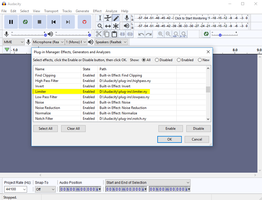

I was using Audacity 2.1.3, I think, and went to use the Limiter effect. It didn’t show up in the effects list at all. I checked the Add/Remove Plugin function, and it said Limiter was enabled. I went through a few rounds of rebooting Audacity, turning Limiter off and on manually, and nothing seemed to work. I tried updating the program to see if that helped, but it still has the same problem–it says Limiter is enabled, but it doesn’t show up in the list at all. It’s very frustrating, naturally. If anyone can help, that would be wonderful. I took some screenshots just to show that everything should be working properly.

By default, Audacity’s Effect menu lists built-in effects first, then plug-in effects. The Limiter is a plug-in effect. Scroll down the list below “Wah Wah”.
Thanks, but I did consider that. I can only show so much on the screen at a time–Limiter is not present in that area, either. (And on previous uses, I would swear it was always in the main list, but memories fail.) No, I did scroll to the bottom, but all it says below Wahwah is: Adjustable Fade, Clip Fix, Crossfade Clips, and Crossfade Tracks.

In my attempts to solve this problem, I updated to 2.2.1, thinking that perhaps running the latest version would solve the problem. I then did a complete uninstall and reinstall, and it still didn’t solve the problem. I literally have no idea what’s going on. Like I said, I used to use Limiter on several different files, but hadn’t needed it for about a month. At some point in that time, whatever happened happened. I didn’t change anything, or install any new plugins. I don’t muck about with system files, and Audacity has always been installed on my D: drive from day one. I install there because the storage space of my C: drive is 150 gigs while D: is 780. So I save C: for the Windows required programs and programs that won’t let me manually change the location for install.

Perhaps. They’re present in the “Plugins” folder in the Audacity folder, but I did try adding them to the “Nyquist” folder, and making sure they were enabled, but it didn’t make any difference. Still, nothing is showing up. I do have to amend my comment about not adding anything, I had recently added the EQ curves download, but when I removed it, it didn’t fix the problem, either. I don’t know if the problem existed prior to me adding that particular addon or not.
