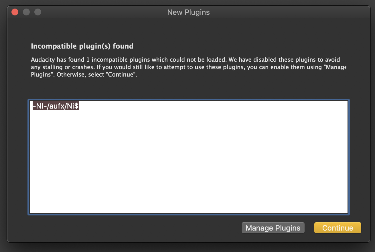

2a: This is now a common complaint, but: We need an option in Preferences to defeat plug-in scanning at start-up. It’s such an annoyance to have to cancel it as it’s going, just to be able to get to work on a project. It should be an option, not an immutable default.
2b: Plugin scanning should be able to differentiate between effects plugins and instrument plugins, and scan only the former.

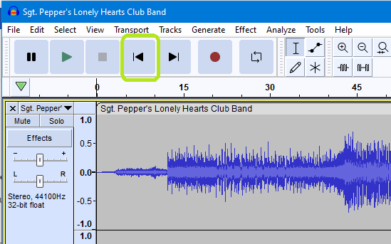

You need to be aware that the top one third of the edge of any clip/track is now used to shrink or expand the clip. Note that in this zone the cursor changes. So if you have a track/clip that starts at T=0 (a very common occurrence) this reduces the target area you have for relocating the cursor to T=0. So yo just need to target lower down in the track.
Personally if I want to move the cursor to T=0 I find it much easier to use the Skip to start button on the Transport toolbar:
Peter.
Thanks for the advice. I just tried it, and placing the cursor lower on the track works fine. As I’d said, this method is easier for me, since the cursor is already in my hand, and it’s usually when I’m already clicking around on the timeline when I need to get to “0.”

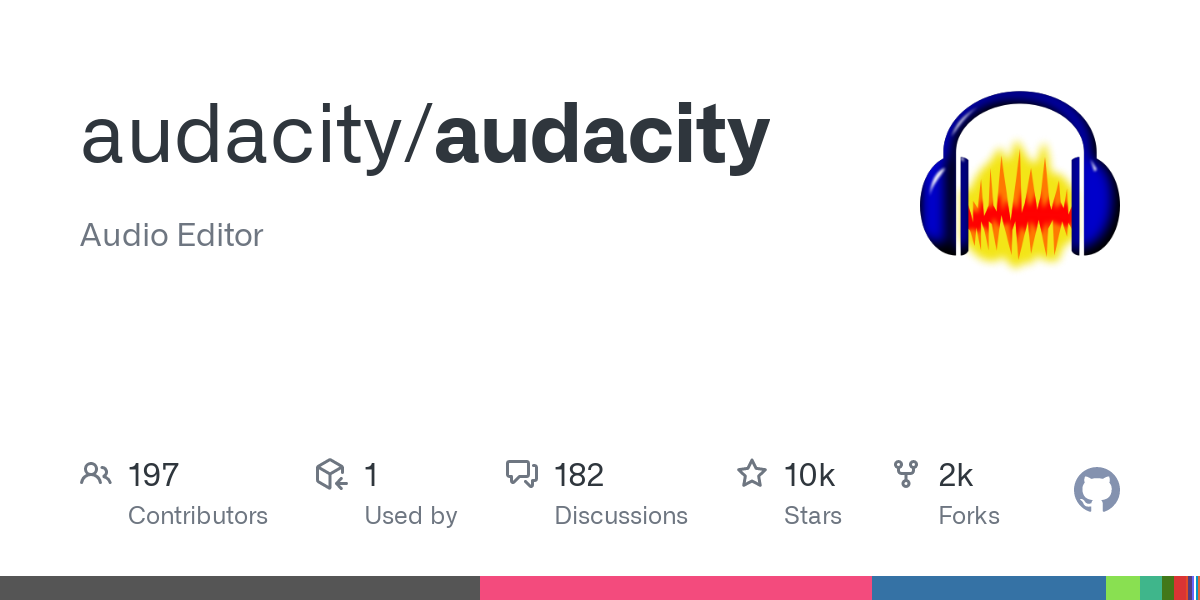

For that you’ll need to lodge an enhancement on Muse’s GitHub issues log:
For that you’ll need a GitHub account - but those are free.

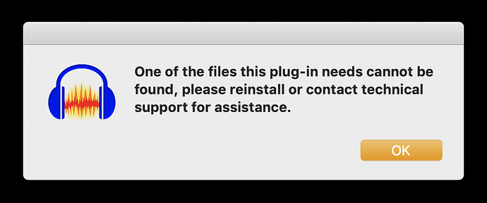

Because Audacity 3.3.3 scans for plug-ins on start-up, these errors occur during start-up. I’m going to try to revert to a previous version that doesn’t scan plug-ins. I’ll wait until the developers wake-up and decide to develop this arrogant function out of the application.
v3.1.3 doesn’t scan for plug-ins at startup; v3.2.0 does.
