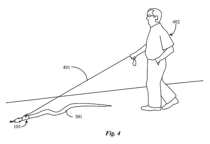

Just because a patent exists does not mean the technology actually works, e.g.
