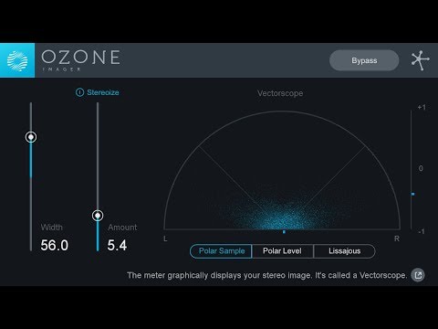

If you can afford the luxury of (pseudo)stereo soundtrack,
IMO that’s more interesting than plain mono for those listening on headphones …

I’m trying to play around with the Ozone Imager, however I cannot find any useful help documentation. Could be poor searching skills. What I have found on the web appears to be for different software than the plugin.
As best I can tell, there are two settings, Width, and Amount. Is that basically what I play with?
Do you have suggestions on settings for those to obtain nice narration enhancement?

Yes Ozone Imager only has two controls.
You can also mix the original mono track with the pseudo-stereo (dual-mono) version …
Just apply ozone imager to the dual-mono track, (to make it pseudo stereo).
All the threes: width=33.3 amount=3.3 & set the dual-mono track 3dB quieter than the mono, (just suggestions).

Hi, I’d like to try this. I have no idea what the settings should be. Are the ones in the pic in your post the recommendations, or otherwise can you help me decide what they should be?
