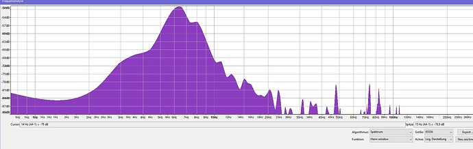

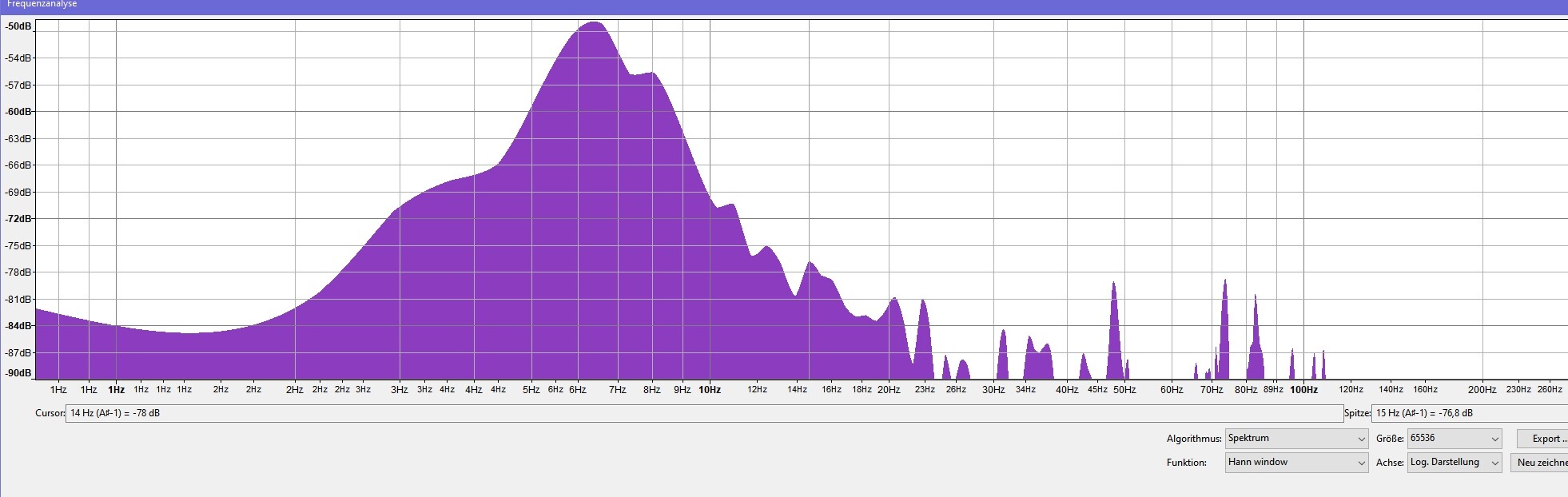

The frequency response doesn’t seem to be quite right yet. Too much at 10 kHz and too little at higher frequencies.
Now I want to have or write an EQ curve that fits the pickup and its environment.
Some parts of the Audacity-menu for the EQ seem unusable to import own data. So I tried to get my own RIAA-curve bei editing EQCurves.xml or EQDefaultCurves.xml, but the new versions have no effect or are not shown at the selection. Do you have any Information or a ‘how-to’?
