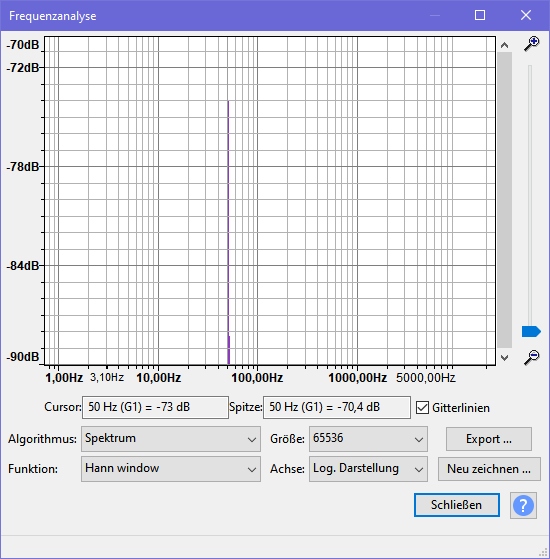

The hum noise is inducted from a transfomer of the turntable, 50 Hz here, and has about ca -58 dB only.
It grows +3 dB when the tonearm comes to the middle of the turntable, an it is stronger at one channel (what may depend on the coils direction of the used cartridge).
A notch filter would work, but I’m afraid about the changed phase at the surrounding frequencies.
I would prefer adding a 50 Hz Signal with 180° different phase to only one of the stereo-channels, if that helps. Similar with 150 Hz if necessary.
How can I adjust an additional track with 50Hz at -60dB exactly to that 180° and mix it to one channel? Or can you help me with another advise?

To generate a 50 Hz tone at -60 dB, with a starting phase of 180 degrees, you can use the Nyquist Prompt
;version 4
(mult  (db-to-linear -60)
      (osc  (hz-to-step 50.0) 1 *sine-table* 180.0))

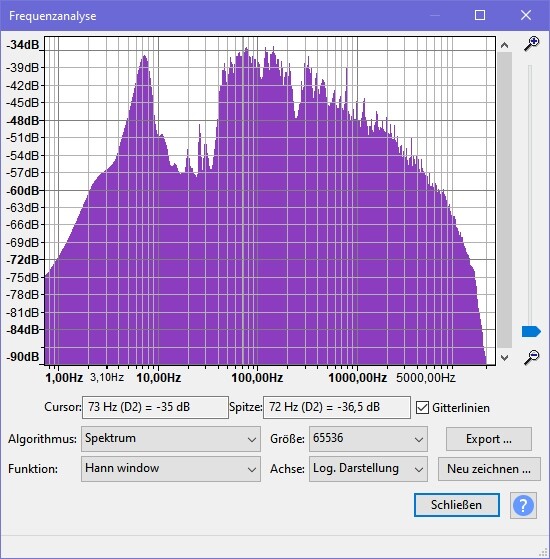

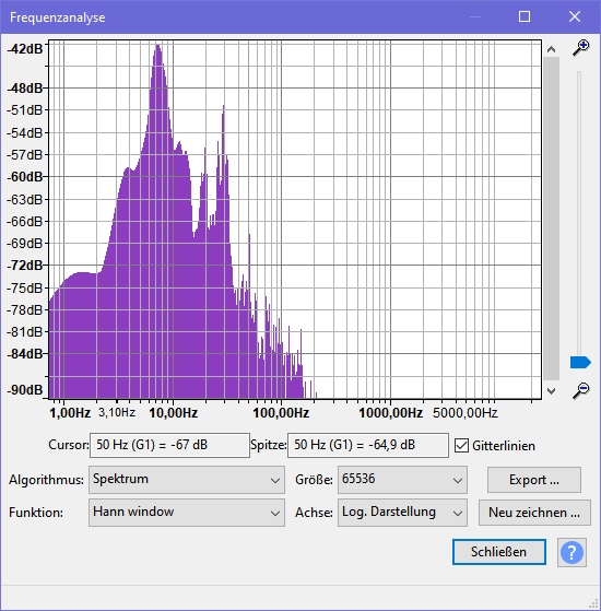

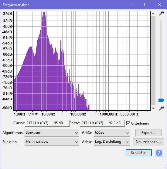

I found other unwanted effects when recording from turntable. There is noise at 7 Hz, tonearm resonance, and noise around 29 Hz - if that is not from the tonearm too, it could be the motor or it might come from the record.
I want to use a Low Pass Filter at 14 Hz with 6 dB or/and a Notch Filter of 7 Hz and Q 4.
Should I use a notches at 29 Hz and at 50 Hz?
