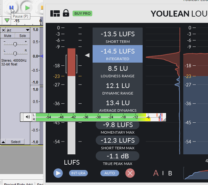

While the show is on the timeline—in whatever form—the bouncing sound meter will tell you a summation of loudnesses. If it starts smashing the right-hand limit and lighting the red alarm, then you have overvolume problems.
Screen Shot 2023-08-12 at 8.55.08 AM
