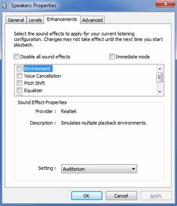

I had not heard of “immediate mode” before but does your “Enhancements” tab look like this?
Basically immediate mode applies changes made to the enabled sound effects “at once”. There seems some confusion as to whether enabling immediate mode means you then don’t have to click “Apply” to hear the changes, or whether you do but don’t have to click “OK”.
Either way, you want to click “Disable all sound effects” so that it has a tick (checkmark) in the box. Then the “immediate mode” box should be greyed out so that you cannot click it. OK that dialogue.

Yes, the enhancement tab is exactly as you have shown.
