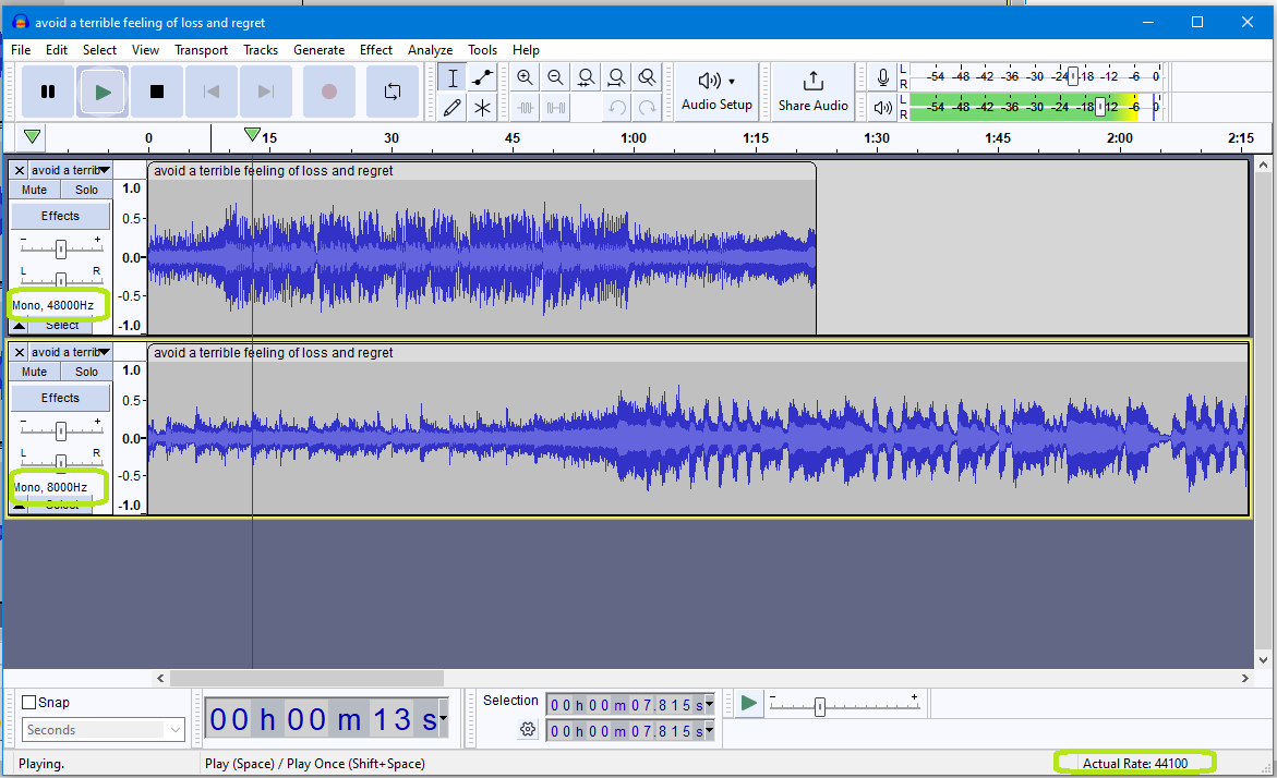

When you are in Play mode (or Record mode) you should be able to the “Actual Rate” at the bottom right of the Audacity window in the Status Bar. This is the Project Sample Rate that is currently in play for the project.
Note that in my example I have two imported files neither of which is at 44,100 Hz but the project rate is 44,100 Hz - so exports will be made at this sample rate regardless of the rates of the individual contributing tracks in the project
Peter
