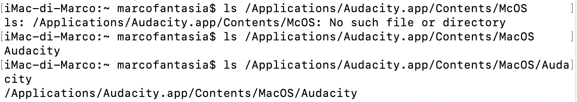

Hello, I just read waxecylinder’s guide to make Audacity work under Catalina, but I have a problem. If I write in the Terminal app “open /Applicazioni/Audacity.app/Contents/MacOS/Audacity” I get a “does not exist” answer. My folder is Applicazioni because I have an Italian version, probably I have to change something else in the string, can anyone help? Thank you.
Marco
Open a Terminal window and enter the command:
ls /
(Note that the first character is lower case “L”)
You should see your “Applications” folder listed, with the correct spelling.
Then enter:
ls /Applications
but using the correct spelling of “Applications” as seen from the first command.
You will now see the correct path to the “Audacity.app” folder.
I see this (attachment). Seems like Audacity is not here anymore, but it is.
Ok, 2.3.2 version seems to work now.
Thanks.
