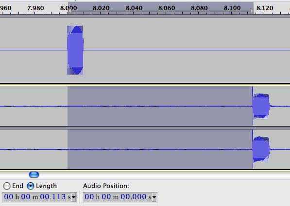

The setup sounds silly but is pretty easy. Create a click track test and use that as the backing track. Go into overdub and jam your headphones against the microphone.
Stop. Measure the different in time between the two tracks. That’s your correction.
Repeat until the two come out even.

Maybe I went by that too fast. Once you discover by how much your overlay misses, use that value to adjust the Audacity latency value and then repeat the test. I don’t know a good way to tell which way to go (add or subtract). It may be listed in the Overdub instructions. I don’t remember writing it, but it may have been patched later.
It should be possible to make a change and then watch the change happen in the test. That’s how you know you went the right way. If you decrease the Audacity Latency Value and the latency error decreases, you’re going the right way. It should be possible to do the test twice (with no adjustment) and get the same error. If the error is moving, then your machine may have troubles.
I expect two or three passes of Test > Adjust > Test > Adjust and your latency value should be almost zero and stable. You should need the timeline magnifier to see the error. It’s never going to be perfect or unconditionally stable, but it should be good enough, as the joke goes, for Jazz.

You can do a really simple stability test. Just jam the headphones against the microphone test twice. The two errors may not perfectly match, but they should be really close. If you get two very different numbers, do the test a third time. If the third test returns yet a third different number, post back.
