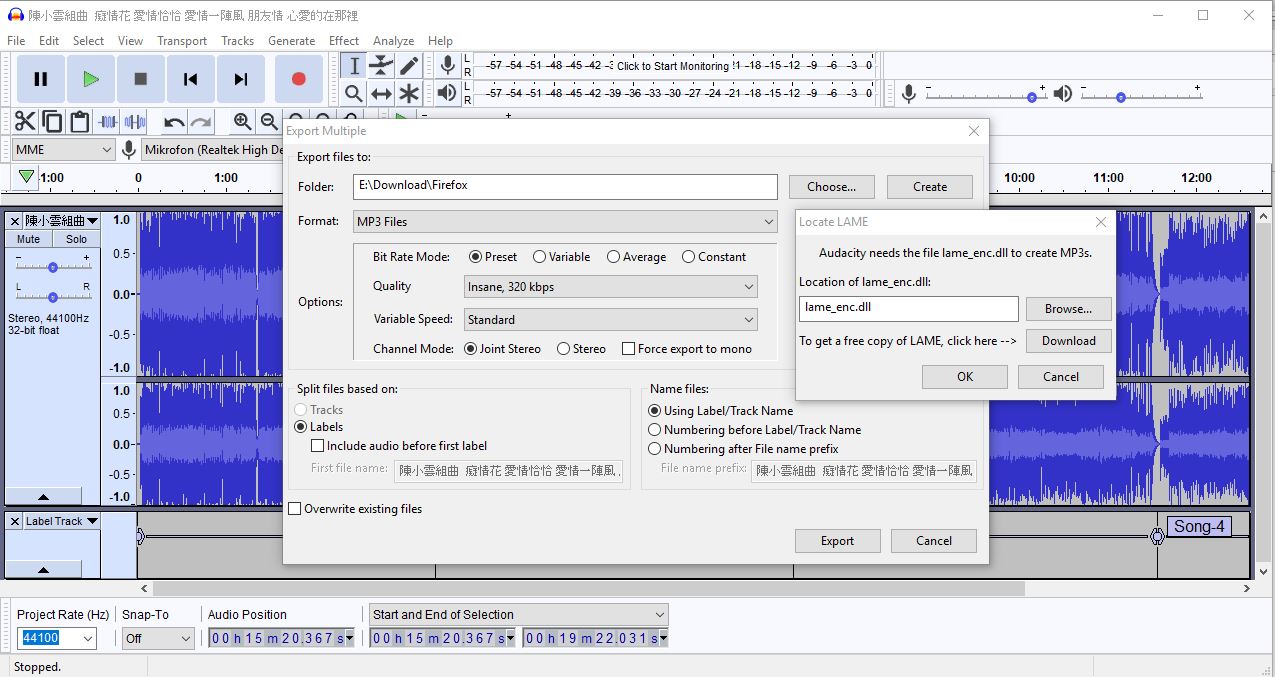

I use Windows 10 and Audacity 2.2.2.
I want to cut a big MP3-file into 5 songs … each a MP3-file.
Audacity needs a lame_enc.dll (see picture) … and I download Lame_v3.99.3_for_Windows.exe.

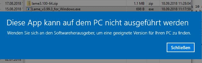

As I try to install lame in my Windows-10 … I get a error-message … telling me that Windows-10 declines to install it.
Did you double-click the exe file to install LAME? Are you an administrator on your computer?

Yes … I double click to activate the Lame_v3.99.3_for_Windows.exe.
I use my computer as an administrator.
How have you installed LAME without error-message?
Thank you.

Maybe I didn’t give you complete instructions - Don’t double-click on the Internet link. First click and download Lame_v3.99.3_for_Windows.exe. Then once it’s on your computer, run it.

Now the installation of Lame is successful.
And cutting a big MP3 to several MP3 files (with Audacity) is also successful.
I used the browser Firefox with Aria2-download-manager. A bug is in it.
I use Google Chrome instead.
