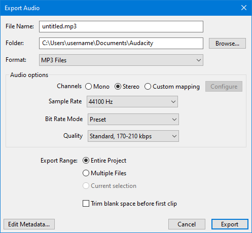

In prior versions of Audacity, when you selected to export to MP3, there was a “Channel Mode” option where you could select mono, stereo, or joint stereo (see bottom of first picture below). However, in Audacity 3.4.2, I no longer see any way to specify joint stereo. Stranger, the online manual still says that this is an option, “Encoding speed can be specified, and Joint Stereo encoding chosen as an option.” (see first paragraph at MP3 Export Options - Audacity Manual), so I wonder if it has been removed in error?
Is this by design or a bug? Is there a way to force Audacity to export in Joint Stereo? Or will I now have to do a further conversion using a third party tool like SoX or maybe LAME (ffmpeg doesn’t export properly to Joint Stereo)?
Old MP3 Export Window (note the option for Joint stereo at the bottom):
New Export window no longer includes a way to specify joint stereo vs stereo:
Maybe I found an answer to my question shortly after posting. I found these articles on third-party sites that Audacity now ONLY exports to joint stereo. Some quick export testing I just did appears to support this.
However, I don’t see this on any of the Audacity pages and the manual specifically states that it’s an option. So is the manual correct or are these sites correct:
Thanks for showing where the Audacity team has formally stated this. However, I would point out that it is in fact still wrong on the Audacity online manual as shown in my original post (see MP3 Export Options - Audacity Manual). How do we ensure the Audacity team fixes this in the documentation?
By the way, I do agree with the point at the link you’ve provided that Joint Stereo is generally better for quality, but I’d also add that it’s important for compatibility with older MP3 players (granted, those are rare these days and becoming rarer every day). Some of them ONLY support Joint Stereo and report L/R stereo MP3 files as incompatible.

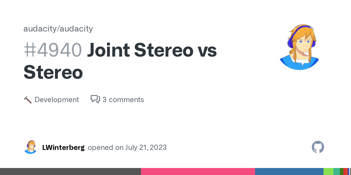

@ClaudeR
See this Muse Discussion thread on GitHub
Muse are unlikely to change their mind about this is my understanding.
Your option basically is to use 2.4.2 (or any version up to and including 3.3.3) if you want to be able to access the genuine pure “stereo” option in MP3 export. In fact I did exactly the same last week for a friend of mine who needed proper stereo MP3 files of a broadcast they had made on BBC Radio3.
