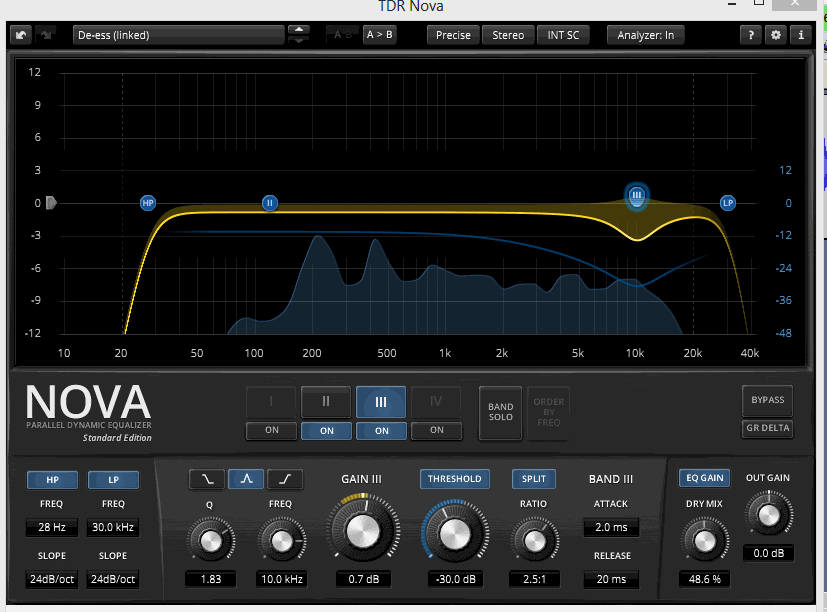

As usual I’ve redid things not happy with any approach, again: I’m working with a low fi recording recorded in a car! a lot working against it not to mention talent-that’s a whole other discussion. So just to get the best out of these here’s what I did:
TDR Nova (parallel dynamic equalizer - free plugin) [adding high pass 15/24, 22kHz-left filter compression 20 dBs/2 ratio] with EQ gain on
GMax9/1 (GVST - free plugin)
SPIT[en] (Spitfish - free plugin)
Loudness Normalization 13.
Side note/question: I mistakenly left the TDR Nova in stereo mode on these mono recordings, I do not want to do over! Does anyone think this changed the results/made a difference? I did a test and it did not seem to make a difference. I did not test mono-TDR applied on a stereo track though, versus stereo-TDR applied on a stereo track (not my concern here…).
