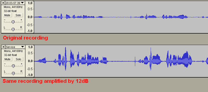

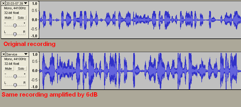

I wanted to get a professional opinion on my recording level. I have the recording volume in Audacity set all the way down (raising it all the way up doesn’t appear to make much of a difference on the graph) and the volume on the mixer is set to about a medium level I think. (not at the auditorium so I don’t remember exactly)
You can see the levels in the pictures I attached, I have been amplifying it because it is definitely low when I play it back. I guess a sound sample would have been a better idea then the images but I didn’t think of that at the time and it is to late to do it tonight, I can upload sound samples tomorrow/later today as it is.

The recording level looks fine - the peaks in the loud part are at about -6 dB (0.5 on the linear scale) which is ideal. However, the tops of the peaks look flat, which indicates that the sound is being clipped/distorted before it gets to Audacity.
If you give full details of the equipment used and how it is all set up we may be able to suggest why that may be occurring.
If you apply the amplify effect with the default options it will amplify the sound so that the new peak will be 0dB, this is the maximum you should have, above that you get distortion. Some people prefer to be a bit more conservative (like me) and amplify to a new peak slightly below 0dB (usually somewhere between -2dB and -0.3dB).
The levels in the first image look perfect, except for the flat tops which suggests clipping prior to audacity recording, as Steve suggested. Without knowing which equipment you used and how you have it connected we can’t say how you can solve that.
The recording level on the second image look a bit too low.

Hmm, yea the peaks are a little flat. The loud part was a video being played on another laptop going through the mixer, more details below.

The softer part in the second image is our pastor speaking, I guess I should raise his recording volume to match up closer to the video. I think the reason I have him down is because occasionally he accidentally blows on his wireless mic or saliva hits it or something and it makes a loud sound. It’s hard to explain but I could easily find a clip of it if you wanted to hear.
