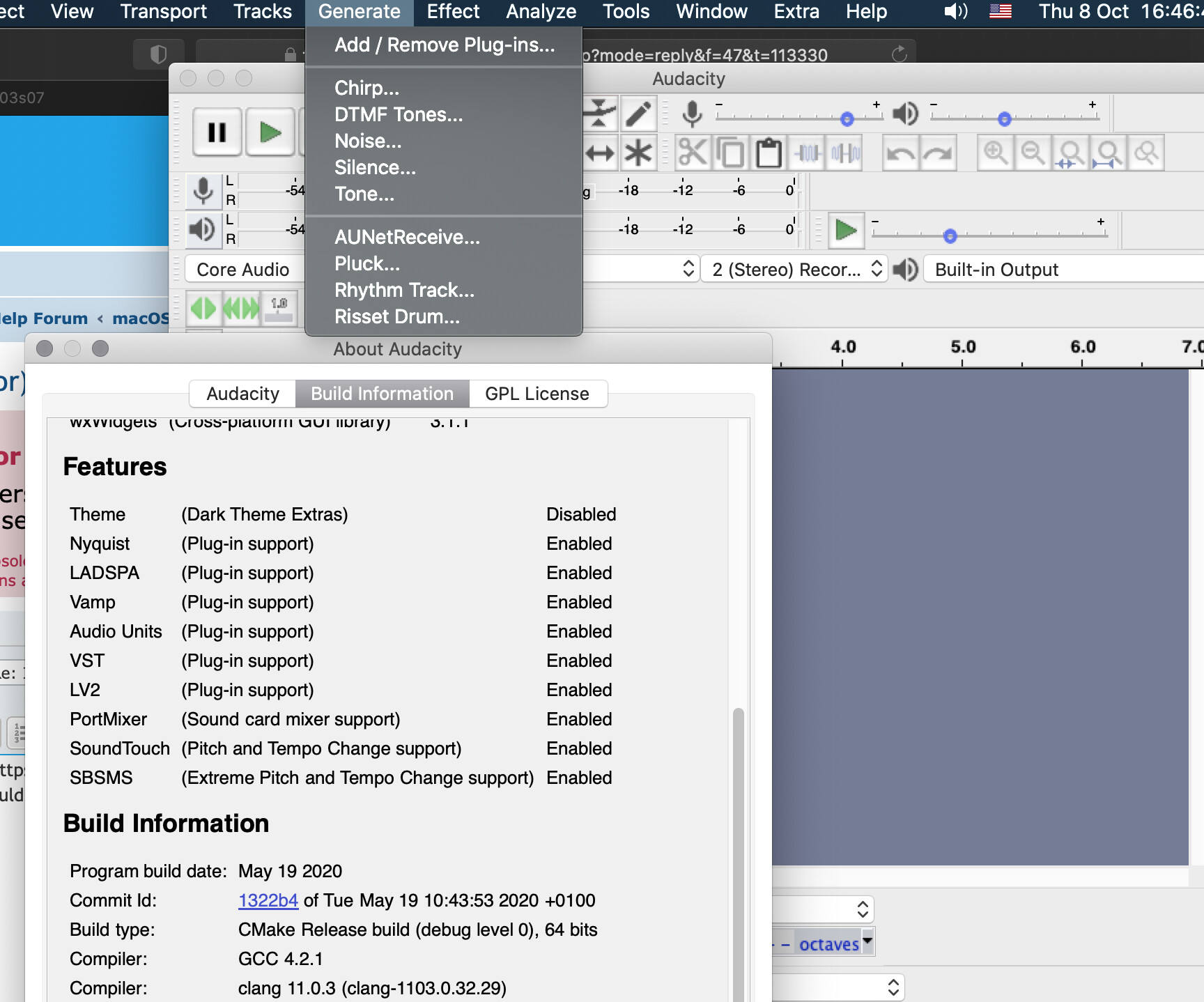

Thank you for filling in bug report, Steve. Please, reply to Peter Sampson who was commenting there that he couldn’t find the effect that AUNetReceive is listed under Generate menu, as it’s a generator (instrument) plugin, not an effect plugin. See screenshot attached.

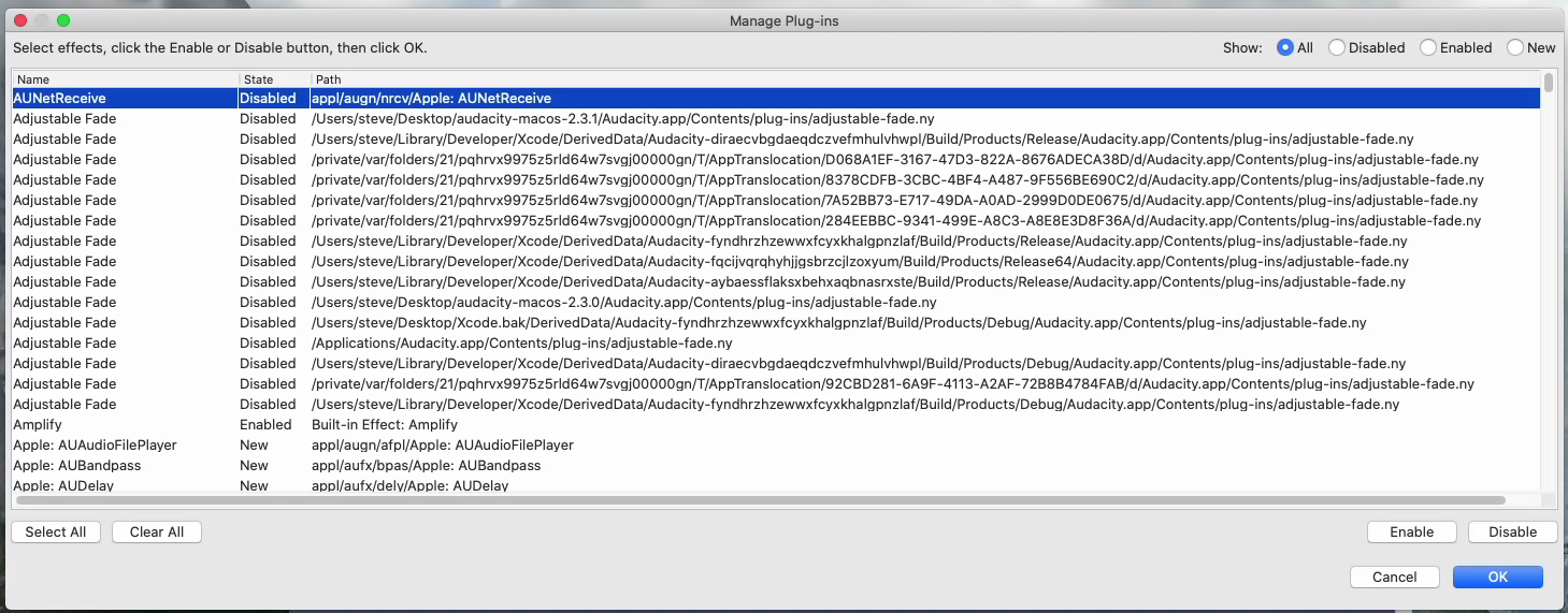

Peter Sampson is me “Waxcylinder” - I don’t see it all in the Audacity Plug-in manager, so I can’t enable it to access it.
I do have AUNetSend - but not AUNetReceive :confused:
Peter.

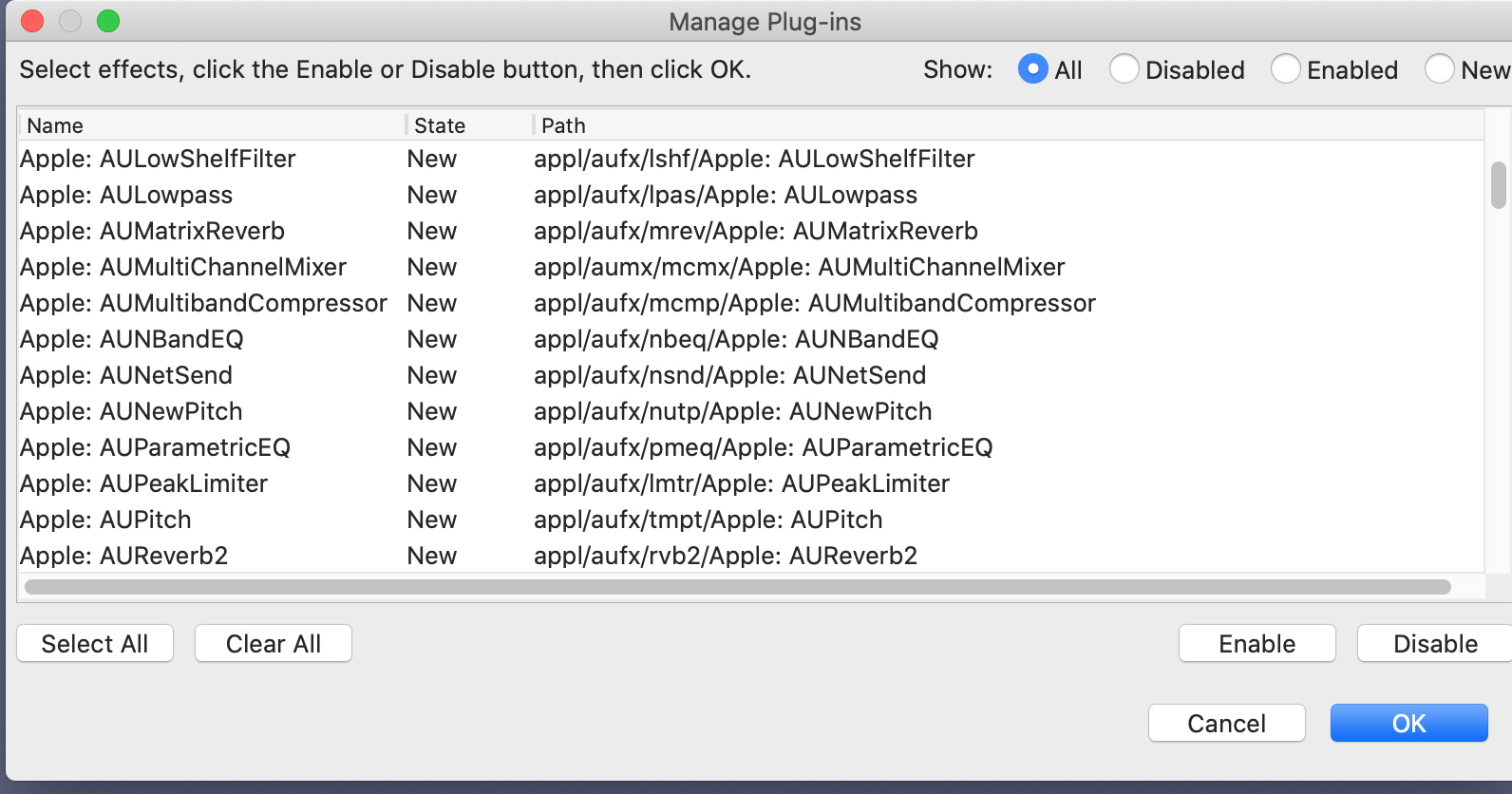

This is how I have them listed:

Adjustable Fade is the top item in my list :confused:
I have no
AUMatrixReverb
AUNetReceive
AUNetsend
And you don’t have (as I have):
Apple: AUNetsend
I have a Macbook Pro running macOS 10.15.6 Catalina
Peter
Once I enable any of ‘New’ ‘Apple: xxxxxx’ plug-ins, then close Manage Plug-ins window, and then open it again, this 'Apple: ’ prefix is no longer shown in Name column, but remaining ‘xxxxx’ (actual plug-in name) is shown.
