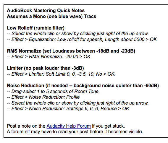

The track has very low volume. I applied Audiobook Mastering …
… and very gentle 6, 6, 6 noise reduction and got the work to pass Audiobook Technical Standards.
You can’t use the mastering tools one at a time. If I correct the RMS, Peak will not pass. You have to use the tools in order.
This is a short version of the wiki posting.

I think we’re playing word games. RMS means loudness. It’s not magic. If you’re work has low RMS, that just means it’s not loud enough.
The noise measurement isn’t that crazy, either. When you stop announcing, your background room noise has to be 1000 times quieter than your voice. That’s what -60dB means.
When you stop talking, your background noise isn’t quiet enough. That’s a very common problem with home performers.

That and the sample has to conform to their technical standards: Peak, RMS, Noise.
When you apply Limiter, remember to change the limit setting to -3.5 rather than the default -3.0. If you leave it 3.0, you have no room for error. Any mistake and the work will fail standards.
