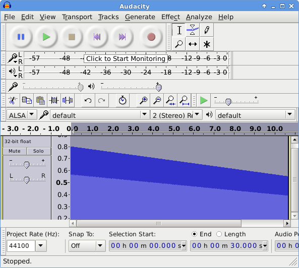

There is a repeatable bug (tested on Linux).
Correct behaviour:
- Open an Audacity window and scale it to almost the size of the monitor display, but not “maximized”.
- Generate a waveform.
- Drag down the bottom of the track to near the bottom of the track window.
- Drag a corer of the main window to make the Audacity interface smaller.
A vertical scrollbar is produced.
Moving the scrollbar up / down allows you to see any part (top, middle or bottom) of the track.
Bug behaviour
Open an Audacity window and size it fairly small.
Maximize the window using the “maximize window” button.
Un-maximize the Audacity window by clicking the “maximize / restore” window button (or whatever it’s called).
Bug. It is not possible to scroll down far enough to see the bottom of the track. -
Resize the window a bit larger or smaller by dragging a corner of the main Audacity window.
It is now possible to see any part of the track.
OK so you cannot do a drag down that shows all the track height in the scroll in a maximised window if you then restore down that window to close to minimum height (I see that on Windows too).
Trebor seems to be saying that you cannot do a drag down that shows all the track height in the scroll in a window of small height. You have to do the drag down first in a tall (not maximised) window. But I still cannot seem to produce an image like this:
by doing the drag down in a window of small height.

Yes I already said I can reproduce that, thanks. ![]()
What I cannot reproduce is the need to first drag the window taller before dragging down the track, as opposed to doing the track drag down in a window of small height. I thought that was what Trebor was saying.
