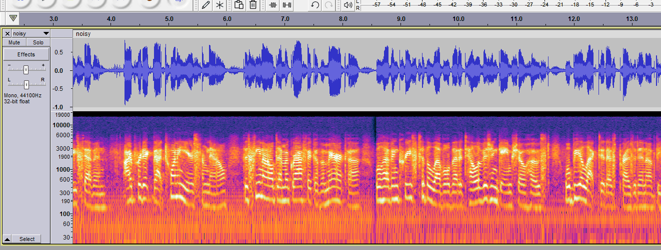

If you can hear software other than Audcaity, (e.g. internet browser, or media player).
The track could be muted in Audacity … Audio Tracks - Audacity Manual
or Playback level slider could be zeroed in Audacity. …
Recently the level sliders were incorporated into the meters so are difficult to spot
(see rectangles on the extreme right of the picture below).
or maybe you need to select another playback device in Audacity …
https://manual.audacityteam.org/man/device_toolbar.html
It was the slider ! Thank you! I never would have stumbled on to this.
