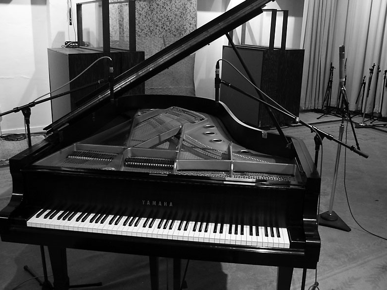

That’s all microphone white noise caused by you not being loud enough, or having the microphone (phone) too far from the performance. This will be sticky because the music sounds OK. So you may fix one thing and lose something else.
If this is a real piano, can you put the phone just inside the lid.
Also, because it’s a phone, it might easily be trying to perform automatic volume on the show. Maybe not. Consult your directions. If the noise comes and goes, it’s going to be particularly difficult to remove.
