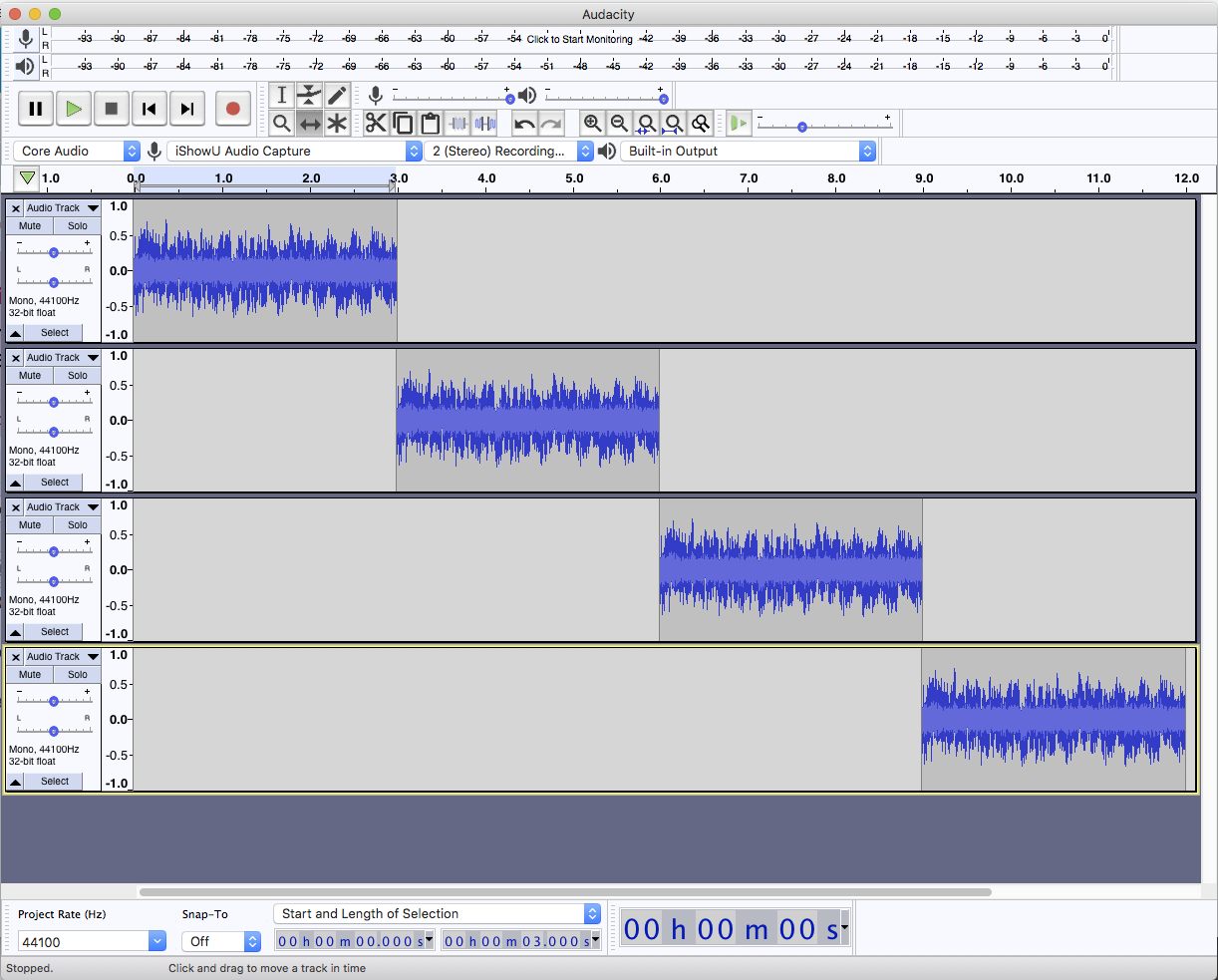

I can think of one way that would work. Open each similarly-dated sound file on its own track top to bottom. Use the Time Shift Tool (two sideways black arrows) to push each track left and right until the order makes sense when you play them. As you noticed Audacity will play everything unless you stop it with the SOLO and MUTE buttons on the left.
Also be clear that the snippets will flop rapidly Left and Right if it’s a stereo show.
There will be a little yellow line when you get the alignment between two snippets perfect.

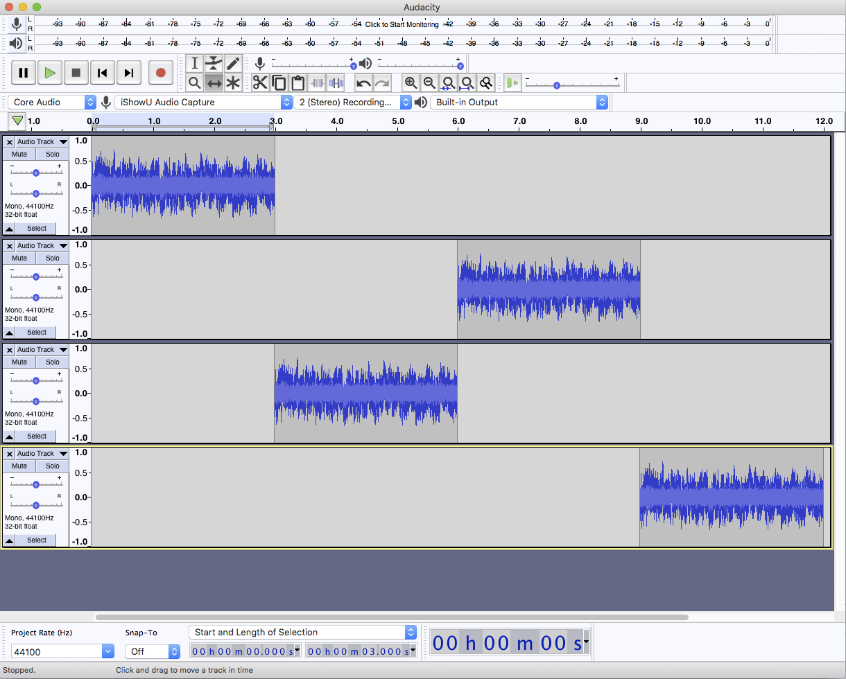

Since they’re random, you might have this. That will play 1, 3, 2, 4.

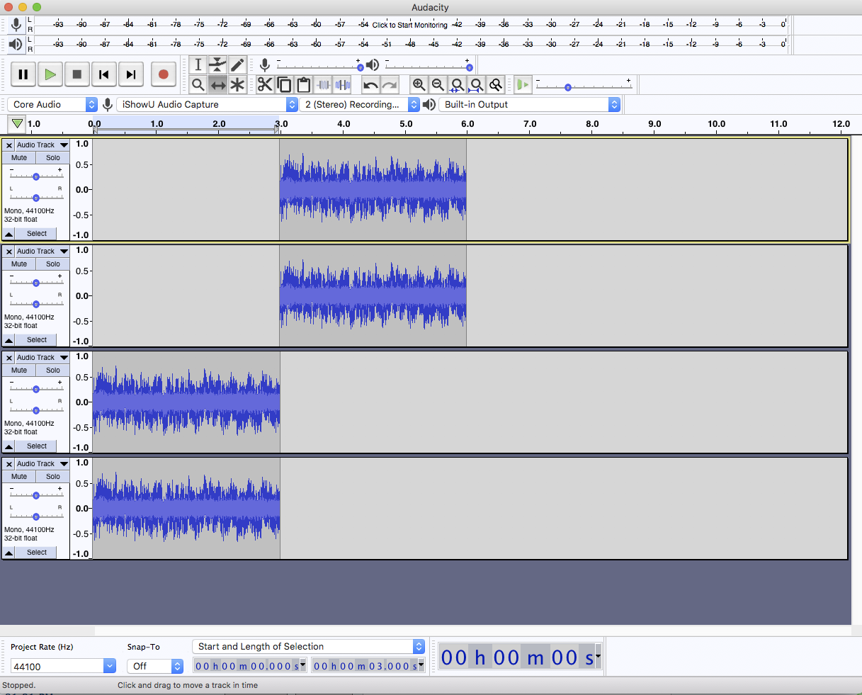

And stereo might look like this.
You can convert each track pair to actual stereo with the menus on the left. Select the top of the two. Make Stereo Track.
