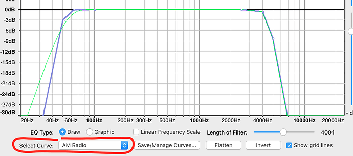

EFFECT —> EQUALIZATION
(Then select AM Radio).
FM
So you want just to cut some of the high end or also make the bass less punchy?
As if it’s being played from a small speaker?
You can modify the AM Radio profile.
Click and drag on the small points to move them.
On the low end, move them to start cutting from about 100Hz and at the high end, move them to about 8-9KHz.

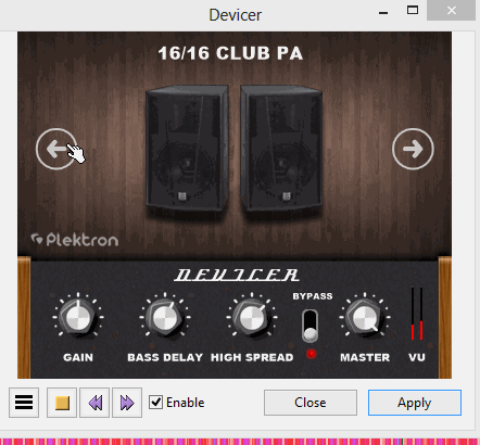

Plektron Devicer is a free plugin which works in Audacity on Windows.
It has a range of audio device simulations, including “Hi-Fi Stereo”.
(The “surround speakers” preset #14 may be what you’re looking for )
