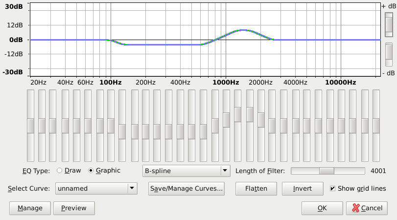

I’m guessing that you mean that you only have the mixed track and that you don’t have separate tracks for each instrument. If that is the case, then there is not much you can do. You could try adjusting the tone (timbre) using the Graphic Equalization effect like this (you may need o adjust the slider positions):
Perfect, you could send the file?
The Graphic Equalizer is included in Audacity 2.1.2 See: http://manual.audacityteam.org/man/equalization.html#graphic
Audacity 2.1.2 is available from here: http://www.audacityteam.org/download/
Yes, but I meant the .xml file.
