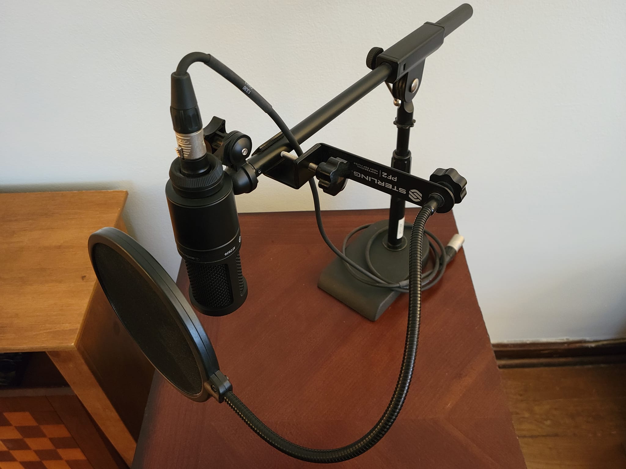

- I’m recording with an Audio-Technica P48 recording mic (see attached jpeg).
- I’m attempting two acoustic guitar tracks and one vocal track, more tracks later.
I couldn’t find that online (AT2020-P48?) but I’m pretty sure “P48” means phantom power, so make sure the 48V is turned-on on the interface.
Phantom powered condenser mics are more sensitive than dynamic mics so you should be able to get plenty of volume.
That is a directional side-address mic and it looks like it’s set-up correctly in the picture but make sure you are recording from the front-side, not the back. (It won’t pick-up properly from the end either.)

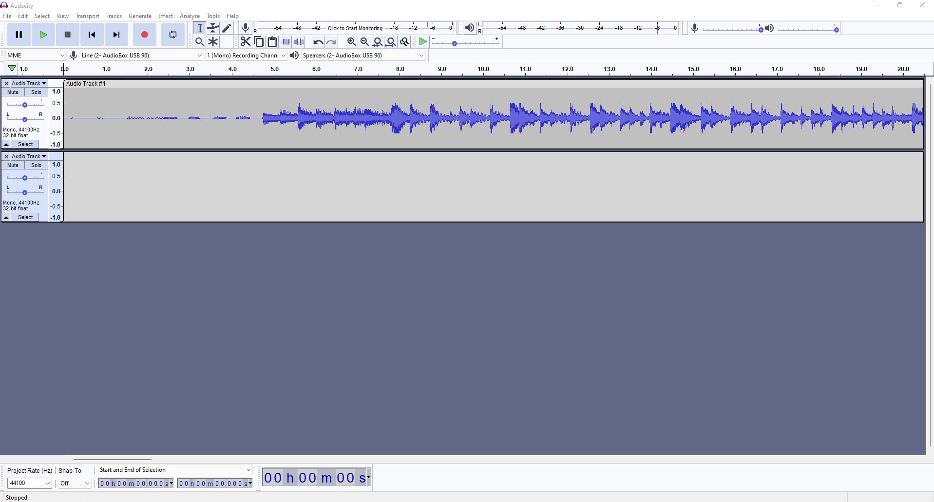

Thanks for the replies, both of you! While I’m trying out those ideas, I wanted to post three pictures which I hope will help someone spot the problem. The music is coming through for record and playback, but very weak. Notice the weak wavelength on the one pic of the Audacity screen.
So those pictures are very helpful.
It demonstrate that you do indeed have a recording issue. But it kind of also shows what the recording issue is. If you do a scratch test on your microphone, I think you will find that the microphone doesn’t pickup anything, but that if you do the scratch test on the laptop microphone - it will pick it up loud and clear.
The solution? Do Transport > Rescan Audio Devices, then set your Recording Device in the Device Toolbar to your Presonus AudioBox USB 96. ![]()

I think that is what the mixer control on your presonus is for. ![]()

It appears that I haven’t resolved the volume problem yet. As the Audacity screenshot (attached) shows, I’m finally getting good wavelengths for the recording of Track 1 (left mono). But in trying to record Track 2 (right mono), the playback sound from Track 1 comes through extremely faint. The second pic attached shows the settings I chose for the AudioBox. Can anyone look at the two attached pics and offer any ideas on what I’m doing wrong to cause this volume problem? I don’t know of any other settings to adjust or buttons to push.
